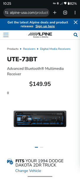

I've put Alpine single-DIN Bluetooth receivers in my 01 ram, my 91 Daytona, and my 90 turbo minivan. Radios are like $109, install kits are maybe $35 with pigtails. Easy wiring, easy install.

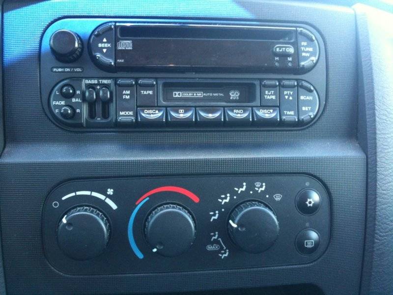

My '03 went last year. Would play for about ten minutes then started making a popping sound then nothing. I pulled the fuse. I'd like to upgrade to one with a screen and backup camera.
Most of those are double-din size. Most early Mopars are din-and-a-half. Earliest double DIN Mopar I had was my 05 Magnum r/t...

You should look up your system in an 03. It might be a factory amplified system. They put the small factory amp behind the passenger kick panel and they can short out. My 98 has that type with the upgraded factory CD head unit.
Finding a back up camera type is not imposible, but will be more difficult and install will require more also. However, you would want to test and/or bypass the factory amp when you do it because that might be causing all the issue to begin with. So your system would be more of a project than what OP is looking at.

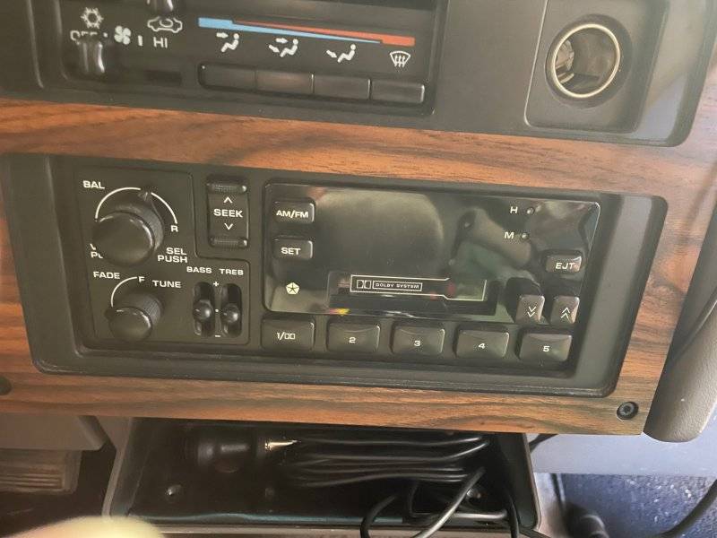

I'll demonstrate my ignorance. I have no clue what DIN and DIN and a half mean...I'm old. Can you help me with a brand, model number and install kit number? Ive attached a picture of my radio. I don't need anything fancy just an AM/FM stereo radio. Carplay might be nice.

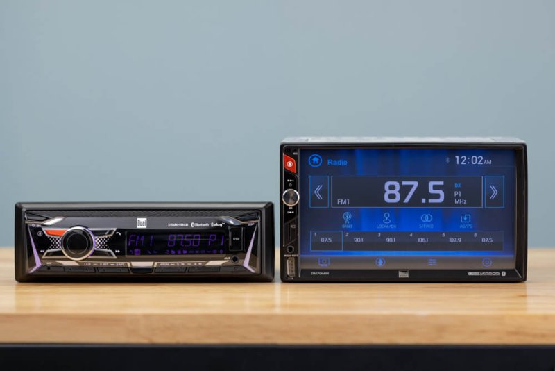

A DIN size is about the height of your HVAC controls. Din and a half is the height of your existing stereo. Double din is....taller yet.
DIN left, double DIN right:
Yours is the recessed, square corner style. This is the flush, rounded corner style
Still din and a half, but different mounting style.
This is what I use. Am/fm/Bluetooth. No CD, no cassette. Good sound, nice menus, good EQ capability.

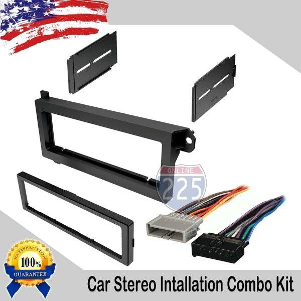

You can find them on eBay, or at a local best buy. And the install kit you need:
Here:
Car Radio Stereo Dash Install Kit Harness 1974-2003 Chrysler Plymouth Dodge Jeep | eBay

Tripplegreen 500, Thanks for sending me a detailed list of the items I needed along with installation advice. Your help made it a plug and play installation. Thanks!!
