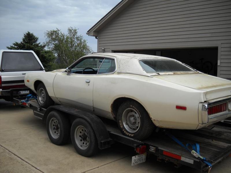

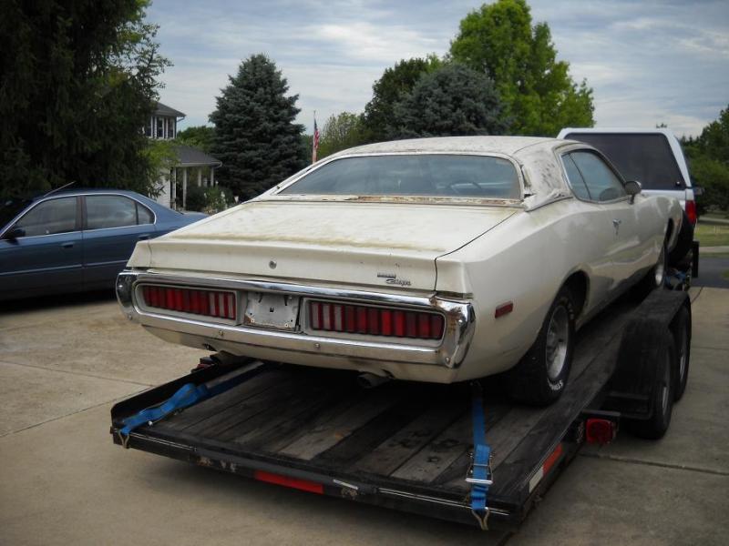

I have a 73 340 rallye charger that I am restoring. My question is, were the front and rear bumper fillers painted to match the car, or were they all molded grey? I noticed on an SE the other day that his were grey with the chrome trim around the fillers, which is only for the SE trim. I'm just trying to figure out if I need to get new ones or paint the ones I have, if they are suppose to be painted. Any help would be appreciated. I added a couple pics to see the area.

My 74 charger SE had grey/silver ones on it. I think the rallye chargers are the same. I have seen them painted body color. I think it’s preference on what you want, but I think grey/silver is the correct way.
BTW be very careful on removing them. They could be very brittle. I soaked mine in brake fluid to get the old paint off, and then washed them with Palmolive. “It softens you hand while you wash the car”.
