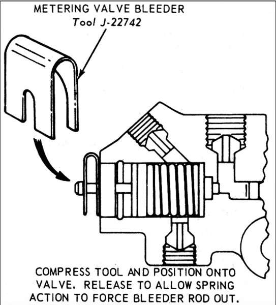

Yes it slid over to close the front circuit. That is how that valve is designed to work.
And theres a tool to assist in bleeding the brakes... You won't find one but you could easily make one.. Or have someone hold the stem in the outward position with a pair of vise grips...
A short piece of banding steel, a die grinder with a cut off wheel & a few minutes will have a serviceable tool..
