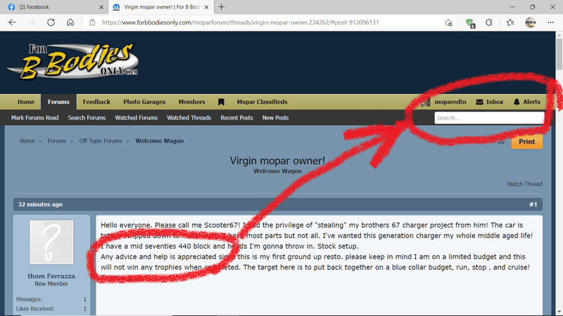

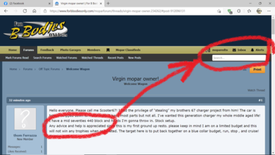

Others have documented doing it also - you need only avail yourself of the most powerful
reference tool this site has to offer:
It ain't a perfect SEARCH box, but it works once you get used to it. :thumbsup:

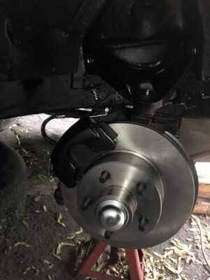

I saw this posting, and checked your site for a kit to work on my 64 Fury. Front Spindle Mount Disc Brake Conversion Kit I see there is an adapter bracket that bolts to the existing spindle, correct? But what are the calipers from? They don't look like the Mopar parts I am used to seeing.. Thank You BBD
They look like a Kelsey Hayes copy. I believe they were standard style calliper for an A body and other cars fitted with discs back in the day.
They do seem to work OK on a bigger car though.

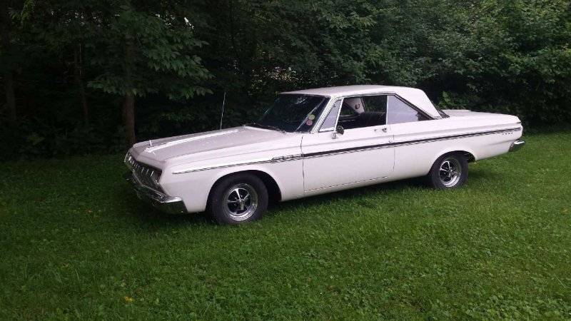

Anybody know if original old Magnum 500 wheels fit over discs? My car has 14 x 5.5 wheels with original spinners from back in the 1960s. I would like to keep them.
The Leed brake kit use the stock drum brake spindle. The caliper is Kelsey Hayes designed similar to what was used on the early mopars (4 piston factory disc brakes) and early mustangs.
