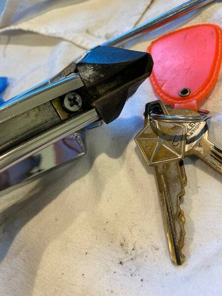

Thanks Jim. I will see if I can find that small screw in the upper part of the Vent Wing. It is not obvious so far on mine. Fingers Crossed. Best, B.
OK, so Jim, you gave great advice by passing on the video, Thank You. The Screws were covered in what looks like Seam Sealer. Once I got that out I found the screw right at the top of the Wing. So, I am delighted that I do not have to take out the Wing Window that I already installed in one of the doors. :) Here is a shot of the screw after I uncovered it. And YES those are the Original Keys and YES, we will be using them as they are. :)
