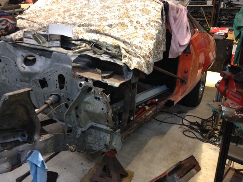

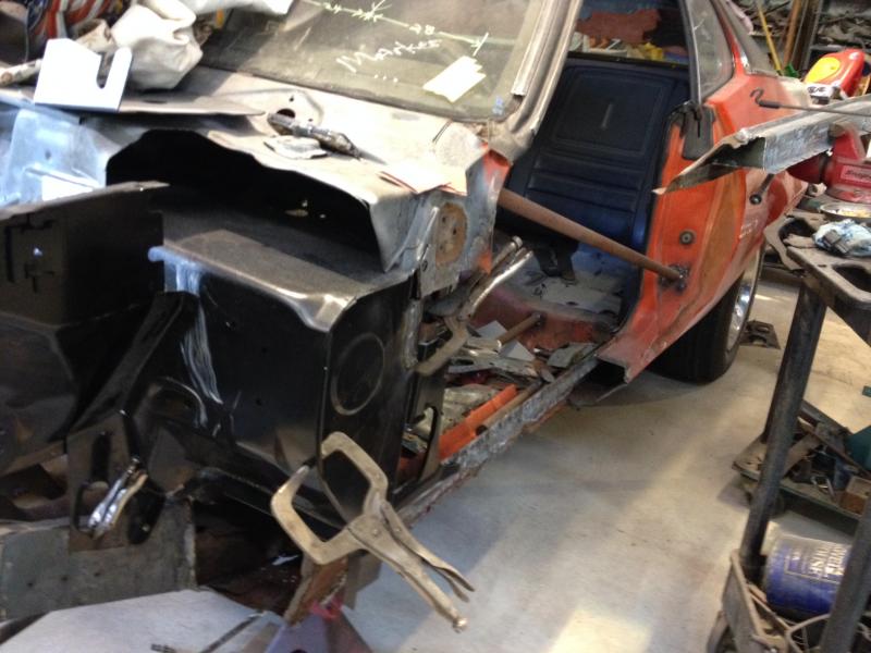

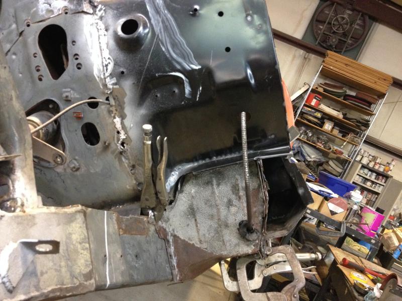

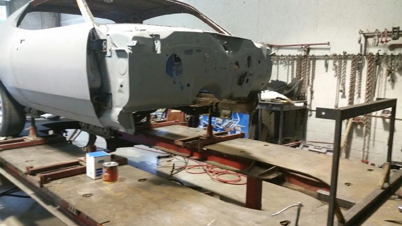

run away, run away......I used the 70-74 E body Outer and inner cowl side hinge panels from AMD on my 72 GTX. I jokingly said run away because if your that far into the car and chasing rust like I was you might be better to cut and run and find a better car to start with. My long and expensive jorney is getting closer to paint but I wouldnt go that deep into restoration again. photo 2 (66).jpgphoto (62)d.jpgimage.jpg606.jpgmoney.jpgphoto 4 (2).jpg

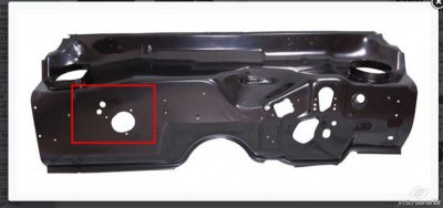

Also E and 71-3B A/C firewalls are the same. Non-A/C are not. Also 74B firewall is different than 71-3B.
B and E top cowl plates are quite different. The well vent holes are different shape and take different screens.
Rob, I too am interested as to how well the E body hinge jam worked on your B body. Comparing originals I found then to be quite different. The spacing for the hinge bolts to be one thing. Also the size of the panels them selves.
I didnt order the firewall side panel thats why I was asking here first :)

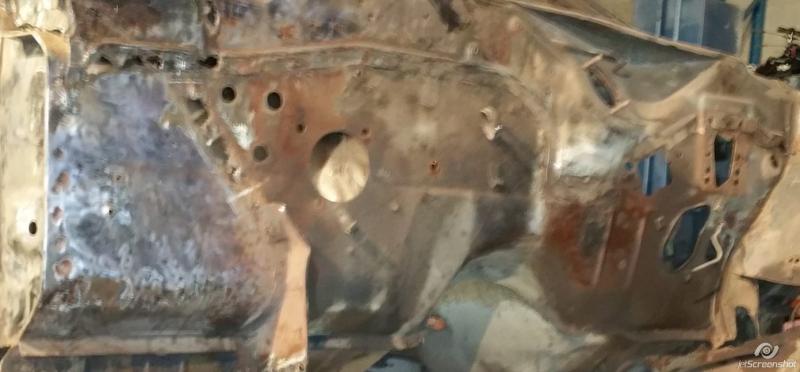

As for the firewall Non A/C it seems to be the same except for where the heater box blower motor and the heater core pipes go through. But I will let you know soon enough how the firewall goes Non A/C. Going to pick it up soon.
I wont be running away from the car :) if i dont replace the firewall side panels then i'll just patch them. The rust isnt that severe. I have almost everything I need for the vehicle sheet metal wise.
My cowl is fixable but installing a new one would of been easier.
attached is my firewall and challenger non a/c firewall
