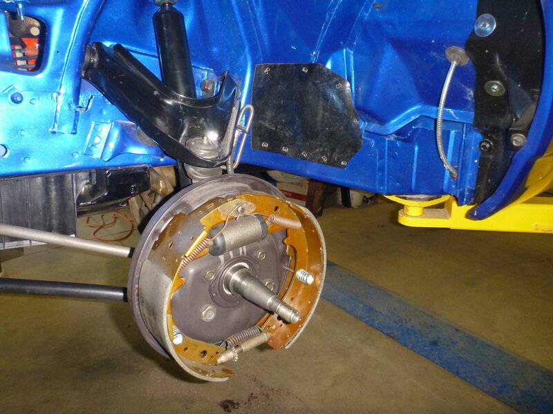

I had a right pull issue on my Bee and found one spot on the shoe was scuffing and no other wear. One of the problems with repro **** and not OE asbestos shoes linings. Slamming on brakes, adjusting for similar drag and I still had the issue. I knew one drum was in spec after turning and one was almost at limits for max diameter. I swapped drum/hubs side to side, did a couple of panic stops and she brakes as straight as an arrow.
