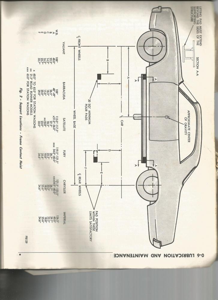

Semi-newbie here, looking to keep my floorboards. Could a fellow 1970 B-Body owner, please post a pic if you have it of the correct and safest front lift, and jack points for a 70 Coronet/Bee? Rear also if you may have it available. Looking to do some tinkering to my 440.

try to jack at the points were the frame pieces come together.always use jack stands and not just the jack.
I always lift under the K-Frame and the rear end center section.
these are lift points for the 72 B body's and are quite similar from 66-72. Hope this helps.
