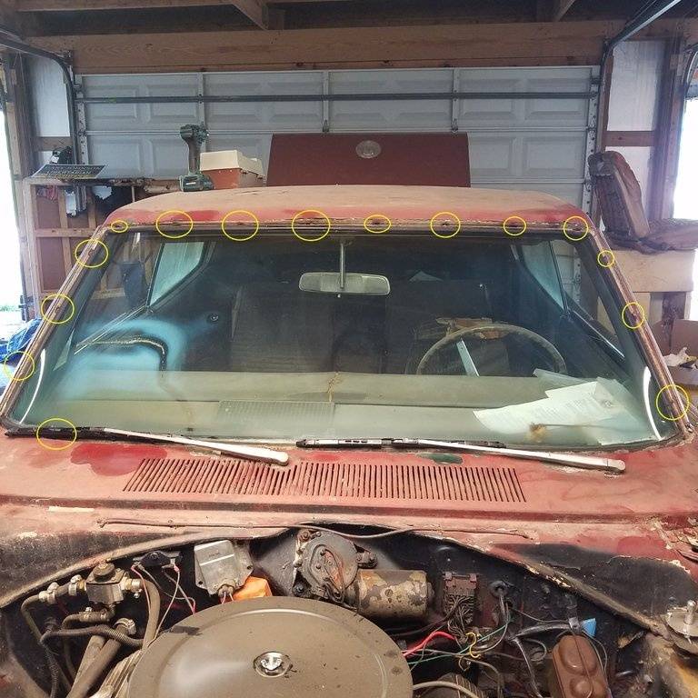

Anyone have any pics or diagrams that show where the clips are? I've started disassembly for resto, and I can't seem to catch the clips near the center of the windshield
I have it in pdf form, just figured maybe someone had a quick pic... I got the windshield trim off, so if anyone wants, I can take a pic and draw circles on where my clips were
Could you send me that please, need to do my front and back, thanks
Yeah, I know I took forever... but... here is it
oddly enough, there was only 1 clip holding my lower windshield moulding on, other than the 2 slot retainers on the ends, anyway, yellow circles is where the clips are at on my car
