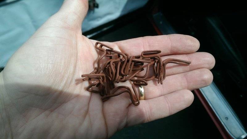

I used the ones in the second picture in our Charger.

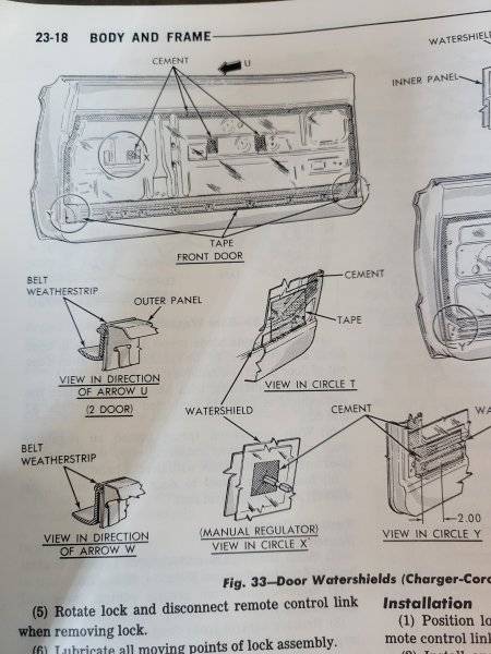

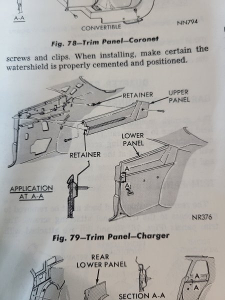

The FSM and parts manuals are pretty neat too.

I’ve found both in the 3 Mopars I’ve owned too. I prefer the stamped steel one but I usually tweak both styles when installing so that they pop loose a little easier for later removal. I think the stamped one don’t show through on the vinyl surface as much as the wire ones.
Closer to 7/8, definitely not 1 1/8.
The specs are in Class.Ind description.
Yes used them on both interior door panels just last week.
Gotta go with 7/8” also. I had a few missing & went to local upholstery shop & he gave me a couple for VW’s. Looked & worked identical.
