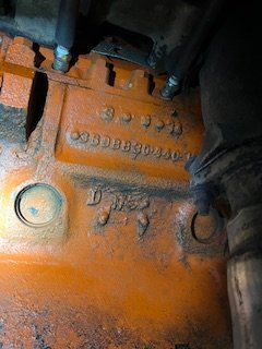

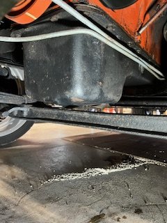

Hello guys...I think first post. I posted on sweptline.org, but because a 440 thought I would try here. You folks have forgot more than this 77 yr. old guy ever knew. Oil pan capacity/dipstick is the big questions. New to me, 68 Dodge D100 short box stepside, with 440 now. Seller told me lots of untruths, but this I know; the 440 is block casting no. 3698830, then date 3-3-73 (or 78?). The pad number is tough, but I believe definite "J", which indicates 1973.

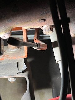

Photos attached. Pan is black, front sump, bottom drain (7/8 hex socket). Seems heavy gauge. Dipstick tube looks like it was born with engine, goes into block above pan, but does not look like most 440 tubes photos seen. It has I would call it a "double curve" in it. Dipstick itself I think is not original, has add, full marks, but a higher mark made with file. Whatever, it was low on oil, with dipstick showing full...I drained out 3.5 qts. I read from info 6,7,8,or 9 qt capacity with that pan
1) What is the capacity of my pan, with or without filter, (6 to 9 qts is quite a range!) 2) What do I buy for 440 dipstick, correct for this front sump bottom drain pan?

The casting number of the 1973-78 400ci is 3698630
The casting number of the 1973-78 "mobile home" 440 is 3698330
Go look at those casting numbers again, to confirm which is which.
The oil pan *looks like* the truck/motorhome 6-quart pan with the drain plug on the bottom. This 440source.com website has a pretty good break-down of 440 oil pans.
If I'm correct about the oil pan, that puts the capacity at around 7-quarts with a filter change.
Great info.... photo is attached, and I suppose there might be some casting slag on that "3" that makes it look like an "8". (ie the second 8 could very well be a "3", making it 3698330. Followed by 440-7, which I suppose could, with slag, be 440-1. So, your motorhome 6+1 likely answer is a very helpful.
the 440source I had gone to earlier, and yes they have excellent photo of this pan; I missed the part where they also said 6+1.
So the 3.5 + 1qt drained out was way low, but how long it ran that way I don't know.
What about my dipstick tube photo, shot from above...doesn't that double curve tube seem to be different than all others? The 440source says any car dipstick will work, but I was skeptical with the odd tube.
I suggest a fresh filter and 7 quarts of oil and see where it registers on the dip stick. I think you'll be fine at that. JMTC
The 440-7 looks strongly like 440 to me, and not 400, another indicator you've got a 1973 440. The -7 refers to the 7th version of the 440 casting, which makes sense for a "later model" 440.
It's hard to say WHY the dipstick tube has a 2nd bend to it, but it's most likely man made. The 1970 part book suggests the same tube was used in both 383 and 440 HP blocks. The same goes for the dipped stick.
I like @ruffcut 's suggestion: change the oil+filter, fill it with 7 quarts, run it, let it sit overnight, then review where the oil falls on the dipstick indicator. If it's wildly off, seek a replacement.

Rishi and ruffcut: put in only 6 qts. 20/50 Valvoline racing, conventional. Ran a minute & no leaks. Shut down for 1 hr. and pulled stick. About 1 1/2 + inches over full. Also about 3/4 inch above the higher mark someone filed into the stick. So I still need 1 more qt., and I am convinced someone shoved any old dipstick in. (probably out of a Chevy, as this is the only non-Chevy he had owned, and it had Blazer bucket seats in it!! My first bad omen on this pickup) I will get a new dipstick to compare, and hope I can add an extra qt. and be right on full. Unless the same yahoo also butchered a chevy dipstick tube and installed that! Seems they are usually priced as a set anyway, and it won't break me up if tube not needed.
