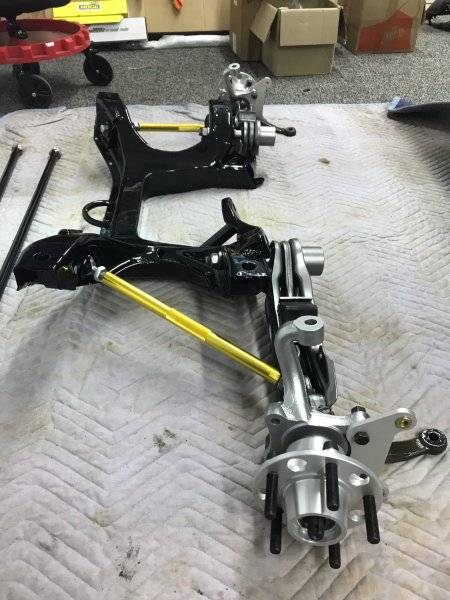

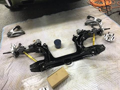

The factory front suspension is well designed and, with some minor tweaks can be set up to very effectively work with both drag racing and handling scenarios. I am completely reworking an RMS K-member and it got me to thinking about what everyone here is using.

I have not experienced either of these issues. The turning radius is much less than stock but the ackerman seems close enough. I can dial in enough caster to where it self centers fine. I have built my own version of it and am now completely reworking the original one I purchased. There are definitely improvements on the design to be made, I have had this one since 2006 and haven’t kept up on if the design has evolved any.

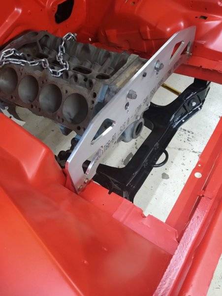

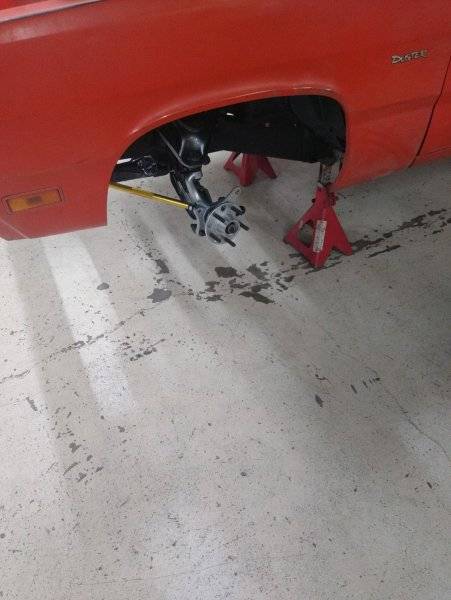

I have no interest in aftermarket suspension/coil-over, for my cars. If I was gonna use it...HDK. My a-body build......
