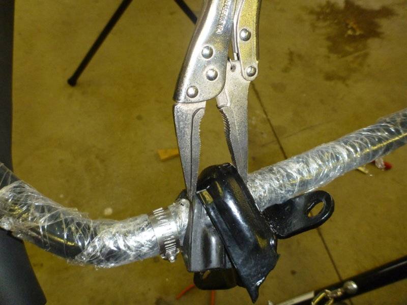

I paint everything apart, then install the bushings. Use rags on the metal so you don't scrape up the paint when squeezing the bushings in. I use a couple of pump pliers and silicone spray.
I just did this. I painted everything first...slid the bushings on the bar....got the bushings in the brackets...then windex on the bar and slid the brackets/bushings into position. A bit stiff but no problem overall.
Getting the bushings in...2 hours for the first one....literally 90 seconds for the second one. I used door shims for small blocks of wood to press the busing into without doing any damage.

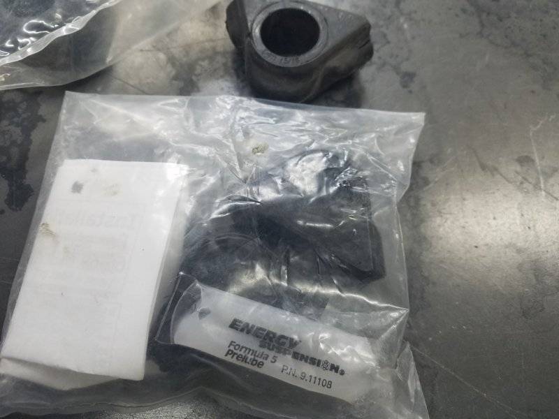

Are u guys referring to a rubber bushing replacement being made for the front OE type triangular shaped brackets, if so where r u buying those. Were u able to find some NOS, or is someone reproducing them. I couldn’t find any anywhere & reluctantly ended up going with the Energy Suspension polyurethane ones......Thanks Jim
Got to apologize to Wayne and the OP. Just dug out the bushings I use and sure enough they are from Energy Suspension. Still not that difficult to get them in after you have done a few and learn the tricks. I have never had to cut and reeled the strap.
