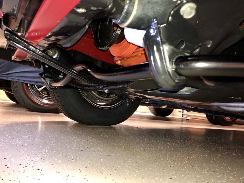

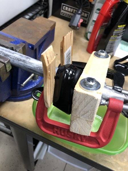

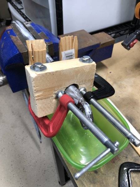

I just did this on my GTX. No need to cut straps. Actually the job was reasonably easy. To remove the old bushing, use a drill and punch holes in the rubber until you can start pulling chunks off with a pair of needle nose pliers, then the rest practically falls out. To put the new bushings in, I used the suggestion on this website from the past on using a piece of wood block and dish soap. It worked really, really, well and was together in no time.
Here is the completed job
Here is the wood fixture to install the bushings, my fresh paint even survived the installation. The C clamps worked great squeezing the bushing in to the strap. Dish soap really worked well. I painted my bar after doing all this.
The wood fixture was a piece of wood with an appropriately sized hole, then cut in half across the hole so the bar could be put in, and then screwed together with lag bolts. You do it at the ends because the bar is ever so slightly smaller in diameter there, makes it a bit easier.
