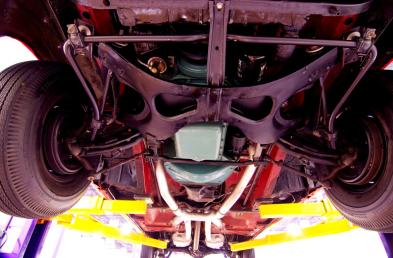

Found this: Notice the 'hangers' at the front of the k-frame and the bar ends are clamped to the strut rods. They're not attached to the lower control arms at all.

Wow!! I just learned something.
For those searching salvage yards: The typical 1966 B-body factory front swaybar matches the photo above, so it should bolt right onto our '65-and-older B-Bodies too.

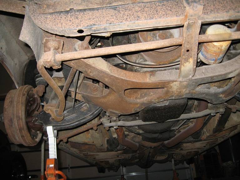

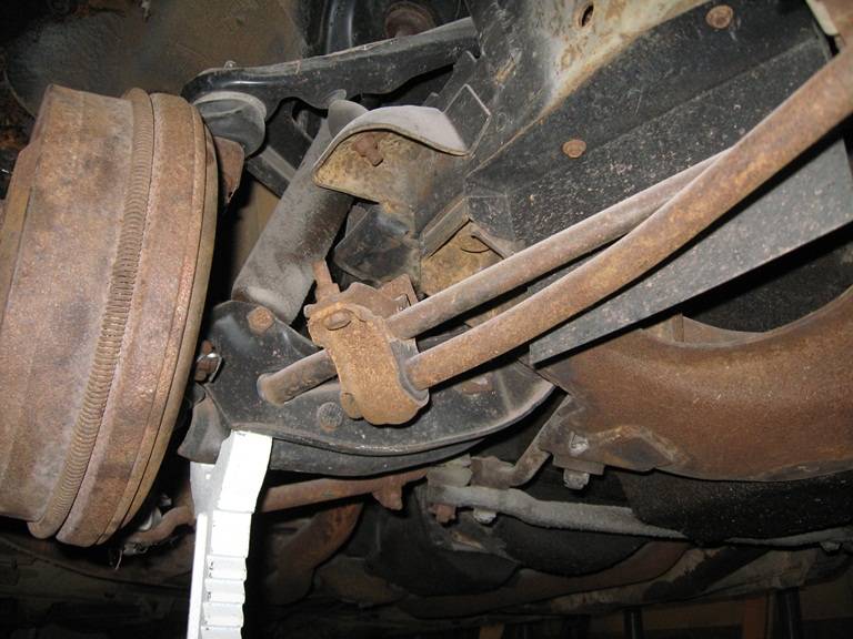

Learn something every day. Took these pics of my '64 Polara which has a factory installed sway bar. Hope these help.

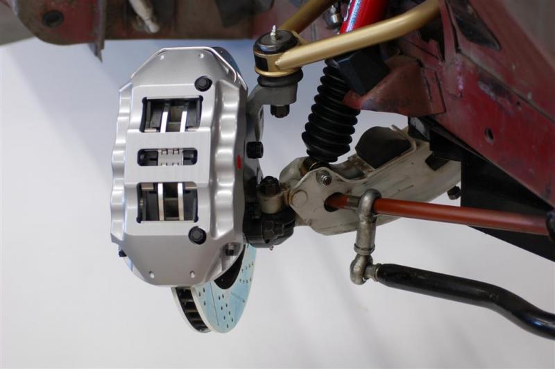

On my '65 Coronet I went with an aftermarket bar that was attached to the strut rods. I did it this way so I could clear a wider tire.
