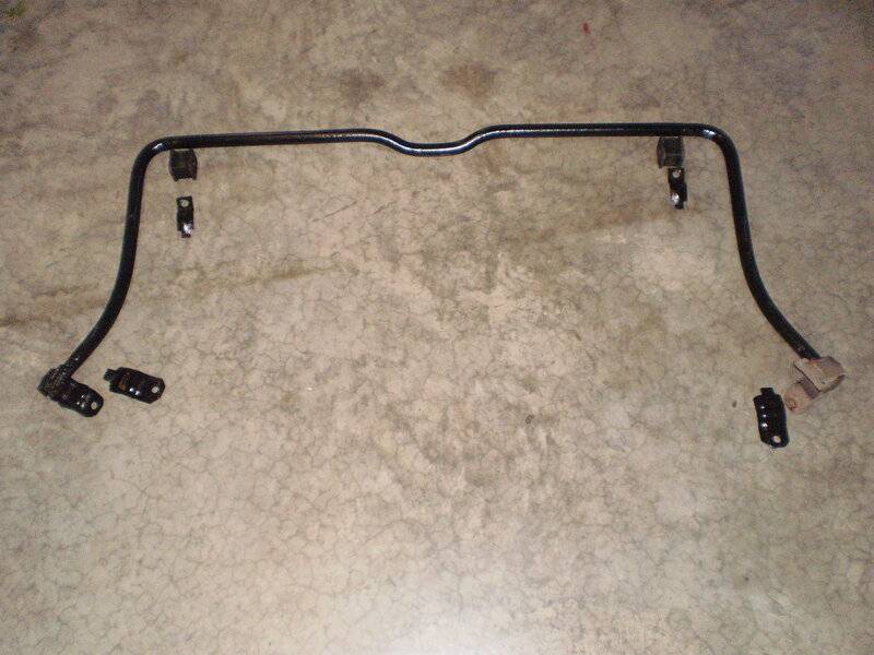

Here are pictures of my front sway bar. It is 7/8" diameter. Layson's have new bushings. It came out of early 1966 Charger, but is same as 1964 Dodge with 426 package.

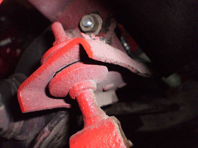

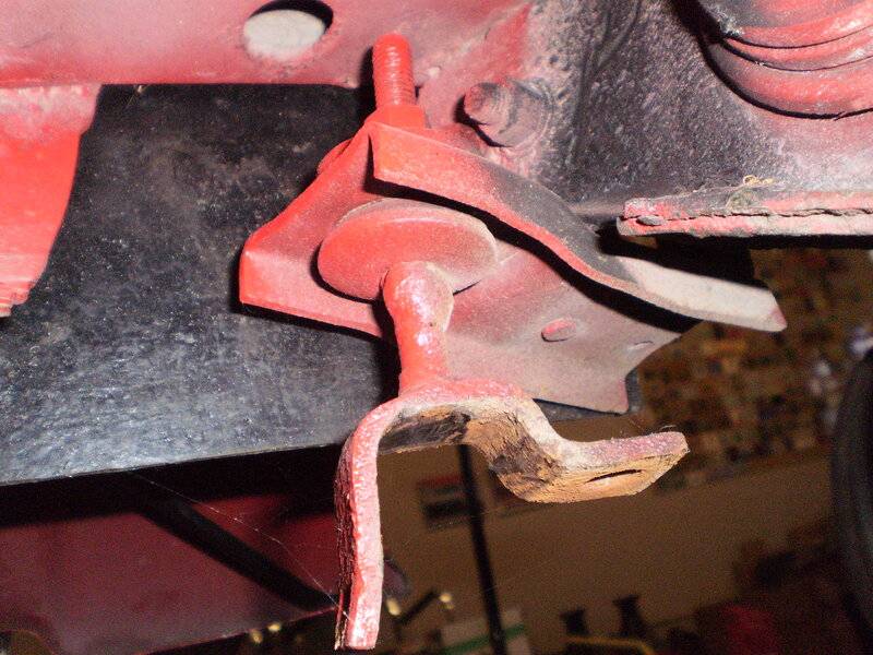

I forgot to add these pictures of front sway bar mounts. Also, I don't think this type of bar is being reproduced. Early '66 Charger is likely your best bet. I saw a bar for sale on Charger site, but it was the later version. Also, here is a Walmart $150.00 group 27 battery with Weskcar $25.00 decal and cap kit installed.

I don't think anyone makes a reproduction anti-sway bar for the early B-body cars. But you can bolt on the B2 style without too much work. www.firmfeel.com is a good place to work with for that.
