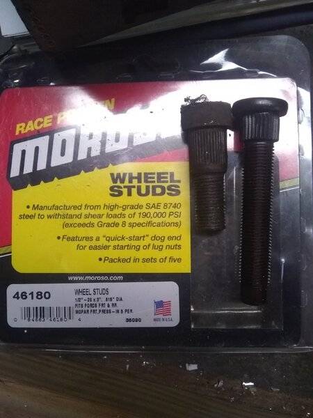

Try moroso 46180. Supposed to be 3" studs for factory disc brakes, .615 knurl. You will need open end lugnuts.

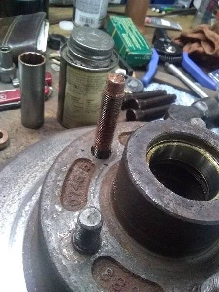

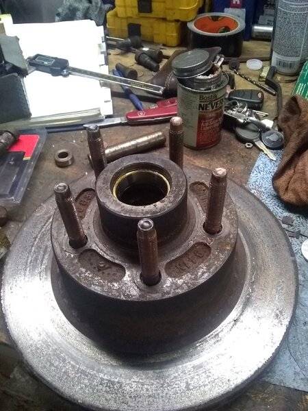

Moroso 46180 is the correct part.
I installed these yesterday, everything went well.
Parts are made in USA, quality seems high.
Overall I have been happy with Moroso parts.
