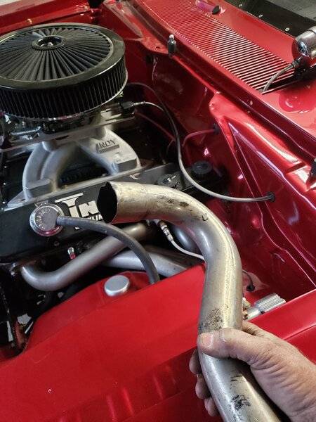

Got a 3rd timeshot due to low car count. Did my burnout and heard an exhaust leak. Staged the car and pushed through the beam. On the return road it seemed louder but really didn't pay much attention to it.
Cooled the car down and went up for first round. Did my burnout and they shut me down. He said he saw water dripping .
I started it back up and he said it was OK.
That threw me off so I lost. Packed up and went home.

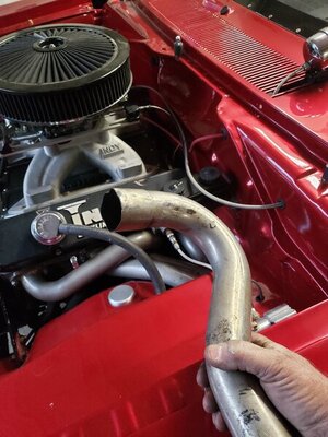

Yesterday after work I pulled my rear shocks to look everything over. I looked forward and saw light coming through the front of my collector on drivers side.
A 16" piece of slip on header tube was gone.

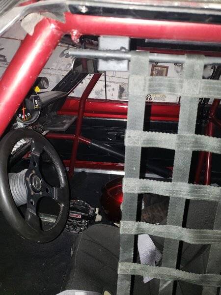

Window net not latching for a first round.

Your bound to have to shake out a few bugs with that level of performance! 440'

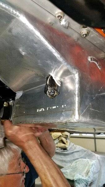

Do you have pro part headers? Had the same thing happened to me but couldn't find mine, a friend welded up a new piece and added tabs to the connecting pieces so I could bolt them together
Yup, pro parts.
They've been nothing but a pain in the *** since I've got the car.
I'm going to weld tabs on that pipe and run a bolt through.
I'm glad that pipe didn't hit someone in the head. Don't you have collector tethers?

Collector tethers Aren’t for the individual tubes that come off.
Yes weld the tabs on and bolt them.

I have collector tethers where they're supposed to be, on the collectors.
