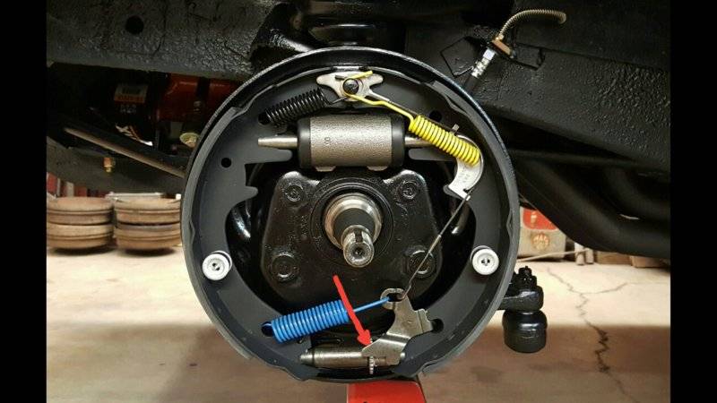

I'll adjust the brakes adjuster from the hole in the back of the backing plate until the shoes just start to drag. They make a adjustment tool that is flat and has a slight angle to it. You can make one out of an old screwdriver also.
This is the left front. You can see that the wheel turns from the top down. The plate against it keeps it from going the opposite way.
If you tighten it too much, you'll have to use a real small screwdriver to hold the plate out, away from the adjuster so you can turn it back.
What I'm describing is doing this from the back, through the adjustment holes.
I'll go to the extent of turning the adjuster until it's tight, push the plate away from the adjuster and turn it back until the drum just starts to turn. That normally gets both sides the same.
Now if you only have a spring that goes over the adjuster, you can turn it either direction. That's the older style brake setup.
Good rule of thumb is to adjust each side until, using moderate force, you give the tire a spin, and it just completes one revolution then stops. Use the same force to spin each tire, and the adjustment should be good, as long as the brakes are clean and in decent shape.

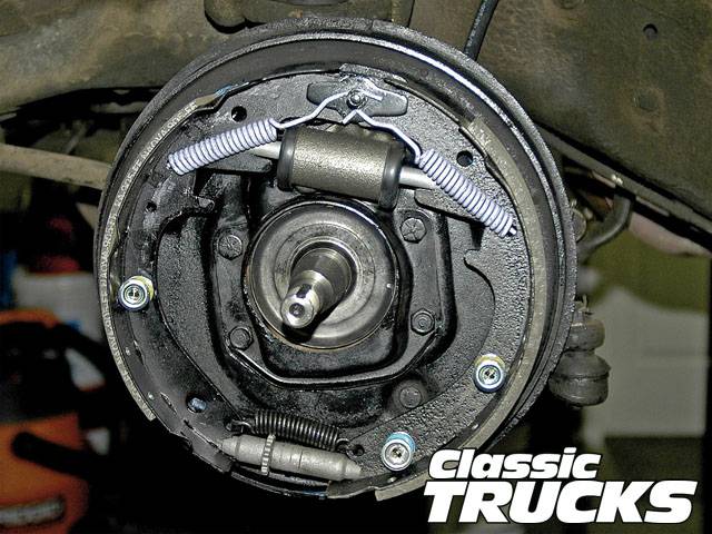

This is what my 67 GTX's brakes look like inside - manual adjustment only. I've found it to be some trial and error. Adjust then go for a drive to center the brakes and then jack it up and do a fine adjustment to even them up. If it pulls slightly to one side, tighten the opposite side a click or two. If the rear seems to step out in one direction - same process back there.
Dumb question,longest shoe goes on back side.
I also start by tightening until the tire won't turn
This centers the shoes in the drum.
Then loosen until you can just start to be able
to spin the the tire with some drag.
Go from side to side so they feel the same.
Works for me.
