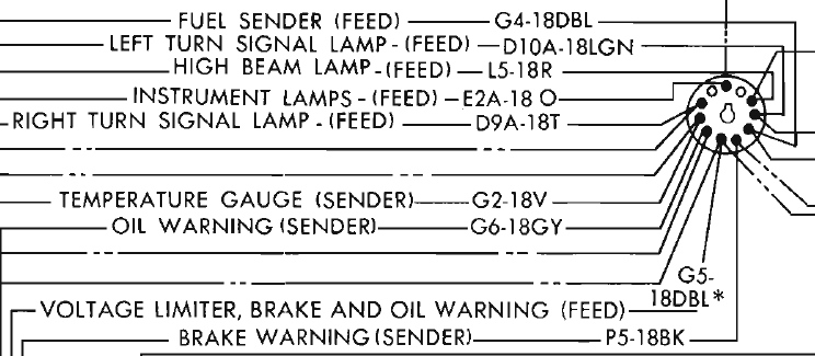

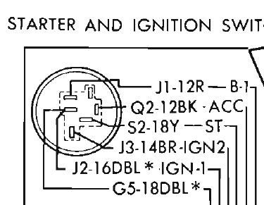

A crop out of the diagrams:
Look at the switch where it says J2-16DBL (IGN 1) this is the dark blue ignition "run"
The wire below comes off that same terminal is G5-18DBL that wire goes directly to the PC harness connector
Look at the cluster connector, find the wire at bottom left, "Voltage limiter, etc" is G5-18DBL. That wire, that pin, supplies switched ignition to the IVR and warning lamps.
IF THE brake and oil warning lamps work, that circuit is getting power. Check the PC board for damage, check the IVR contact fingers for good contact, and the gauge nut studs

It looks as though the brake warning light (which works) is fed current through the same dark blue wire that also feeds the voltage limiter. So I am assuming the circuit board has power to the IVR. I will pull the cluster and check all the connections for good contact.
