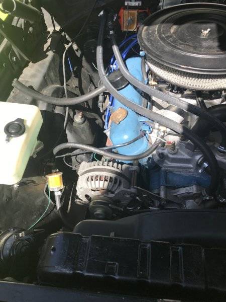

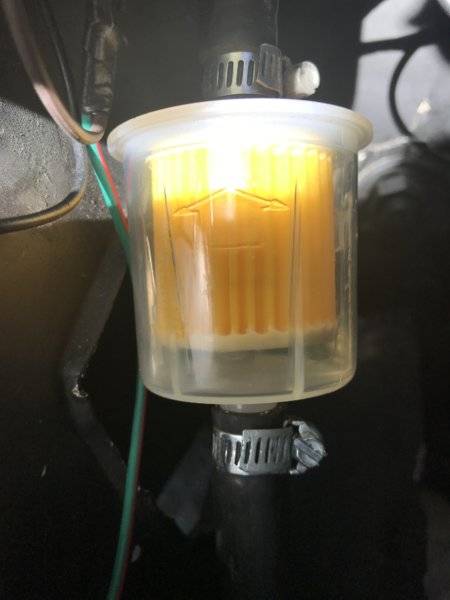

I’ve had this issue for a month now since getting new carb. First sign: I went to accelerate over an inclined road (train overpass) and all of a sudden air fuel gauge goes way lean, car is stumbling, I’m pedaling it the whole way up, levels out and clears up. So I thought-fuel delivery issue- added a 3/8” tee, a second 3/8” line and made the Edelbrock avs2 650 a dual feed Carb. Problem happens again on flat road and I notice the fuel filter is bone dry. Took 30 min to restart and prime line. Next logical assumption- failing fuel pump, so I buy and install a new edelbrock fuel pump. Happened again today, took 30 minutes to reprime the system again. Same thing, no line pressure or fuel in filter. So I have the following new stuff:

3/8” pump outlet and 3/8” all the way to carb. It’s been a rough car month. Open for any suggestions.

Wondering how fuel boiling would cause an empty fuel filter ? Not being rude, just an honest question.
I just drove the car 30 min ago and filter is bone dry.
Well I just tried to start the car and it’s “flooded”. Fuel splashing out AND I can hear it boiling! I have a 1/4” gasket I’ll put on the base and see if that helps. Good call “hash maker”.
Not to state the obvious, ok I will, and as has been posted...the filter getting dry means no fuel reaching it so a pressure check should be done and could do with the front end raised up on a jack (following that you said it happens on an incline only)? That filter looks unusual to me anyway pretty small as is its location...is that the stock setup? Seems the typical arrangement is horizontal nearer to the carb. Did you try putting in a different fuel filter? Hose should be fuel grade. Check the line from the new tank to the pump ensuring there are no kinks or hard bends. I reckon the sending unit was sealed fine when you put that in? If not you would likely have smelled gas around the rear of the car.
