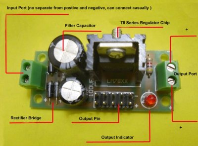

Hi Martin! For people that are not that handy with soldiering can this be used?
http://www.ebay.co.uk/itm/LM7805-L7...]Ys, looks like that one can be used as well.
You can use that one, but you don't need 99% of the parts that come with it. For instance...
1) The Rectifier Bridge on this one is used to convert AC to DC. Your signal is already DC...
2) The Filter Caps are there to smooth out the holes (voltage loss) left by the previously mentioned Rectifier conversion circuit. In this case, the caps act like storage batteries which discharge, to help smooth out the voltage signal "somewhat", making it a little more continuous, as opposed to the hilly (choppy) up & down down signal left after rectification.
3) You really don't need an LED Indicator either.
4) I haven't seen the circuit, but the Resister on the card is undoubtedly there to regulate the voltage to the LED Indicator.
5) You only need one Output Port, the other pins are just fluff.
I think the idea here is to protect the board from accidental reversal of the 12v supply to it. It's almost a must for products that are going to be sold to the general public. It means increased production cost but probably a whole lot less returned, sooty boards...
It's already marked... but yeah, there's no such thing as sailor proof. I doubt very much that the manufacture was thinking about that however. They're only concerned would be versatility of application... killing two birds with one stone.
