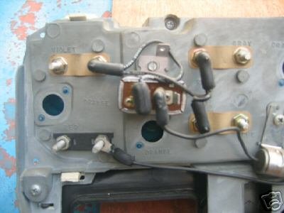

Do you have a rallye or standard cluster panel? On the rallye, you should have a multiple end black wire that runs from the voltage limiter to the temp, oil and fuel gauges. There is also a blue wire that comes out of the main harness. It plugs onto the fuel terminal furtherest from the limiter. Same configuration whether you have a tach, clock or neither.
Yep......and if you have the standard style cluster (Non Rally) it will have a 10 pin connector and there will not be any wires to the studs.
Go here to see pic's of my Non Rally dash.......
http://www.forbbodiesonly.com/moparforum/showthread.php?p=126967#post126967
Here this is what MRHWS is talking about RE: the black wires....I'll try and dig up a nice Rally pic for you....If you PM me your email I'll send you 2 wire diag I have,they won't up load here.
I have the regular satellite dash.
