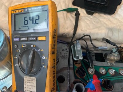

Fuel gauge still not work
New Gauge and sending unit installed, wire's metered and ohmed , we grounded the grounds front and back
All other gauges seem to be working. Getting 64 ohms off tank, when the gauge is grounded it sweeps as it should, 5 volts on circuit board

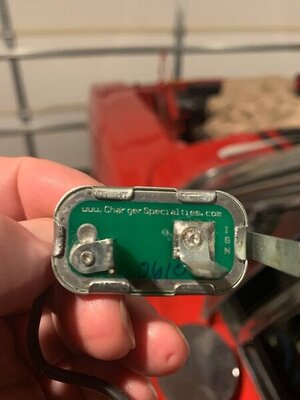

Going to ask the obvious....have you replaced the thermal-mechanical OEM instrument panel voltage regulator? With the electronic type being offered by RTEngineering? As long as you've gone to all this effort and expense.....why not. The electronic device offers protection for the instruments incase of sending unit failure. Just my opinion of course...
BOB RENTON
www.rt-eng.com/index.php/RTE_limiter.html

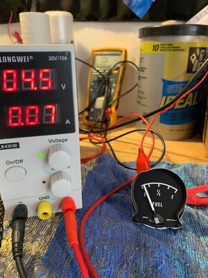

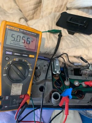

1) Tested gas gauge, seems to work fine, goes up and down as I change the voltage
2) Rather new voltage regulator. 5 volt output.
And thinking to replace the circuit board while I'm here but don't think that is the problem
View attachment 1258851 View attachment 1258853
The RT_Engineering voltage regulator was just a suggestion....it appears that you have already replaced it with the www.ChargerSpecialties.com unit....very similar. Change the circuit board????....its up to you....can't hurt....

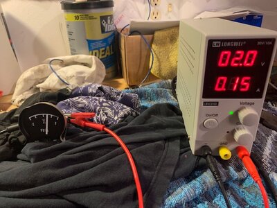

Pulled sending unit and wired directly to gauge
Sending unit runs from 75 ohms (empty) to 11 ohms (full)
Gauge unit runs from 66 ohms (empty) to 11 ohms (7/8)
Don't get to E mark on the gauge until I get 66 ohms
So, do I look for a different Sending unit? I need to lower the resistance, adding a resistor will not fix the problem, am I looking at this correctly ?

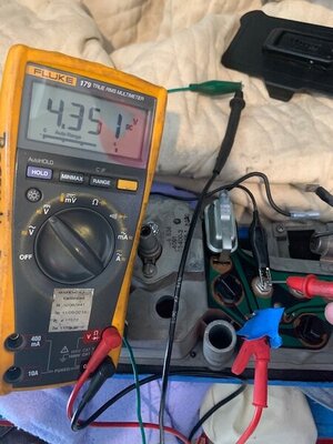

Appears your bench power supply voltage is set a tad low, needs to be at 5-5.5 volts. Sender resistance readings appear nominal per spec.
Was wondering about that. Didn't want to toast my new gauge. Will run up to 5 volts and update

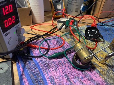

Next, I would bring the aftermarket voltage limiter into play on your bench testing. Supply 12-13 volts from the bench power supply to the limiter, then from the limiter to the gauge. Voltage limiter could be failing to maintain the 5 volts while under load.
Just noticed you believe your temp gauge is “toasted”. Has it been removed from the circuit board? If temp gauge is shorted, it cold mess with the voltage limiter function while these components are connected in the circuit board and under load.
Installed voltage limiter in test circuit, works perfect at 5 volts. All other gauges are working properly. After cycling float with gauge hooked up many times, can see how gauge lags the float level and seems to be more inaccurate below half tank. Thinking the float is not matched to the gauge or just not working properly.
Pic is at 60 ohms at empty mark
I would now assemble the gauge and limiter into the cluster frame, make your connections at the circuit board pins, bench test once more prior to installing the cluster back into the car. Reproduction sender? Not uncommon to have to verify the same full sweep range on the sender out of the tank, corresponds to the float locations in the tank. Requires visual inspection, likely some bending adjustments are required.
Yep have a new sending unit coming and will put it back together in stages, but still need to get gauge and sending unit to match. Nothing worse than a inaccurate gas gauge
