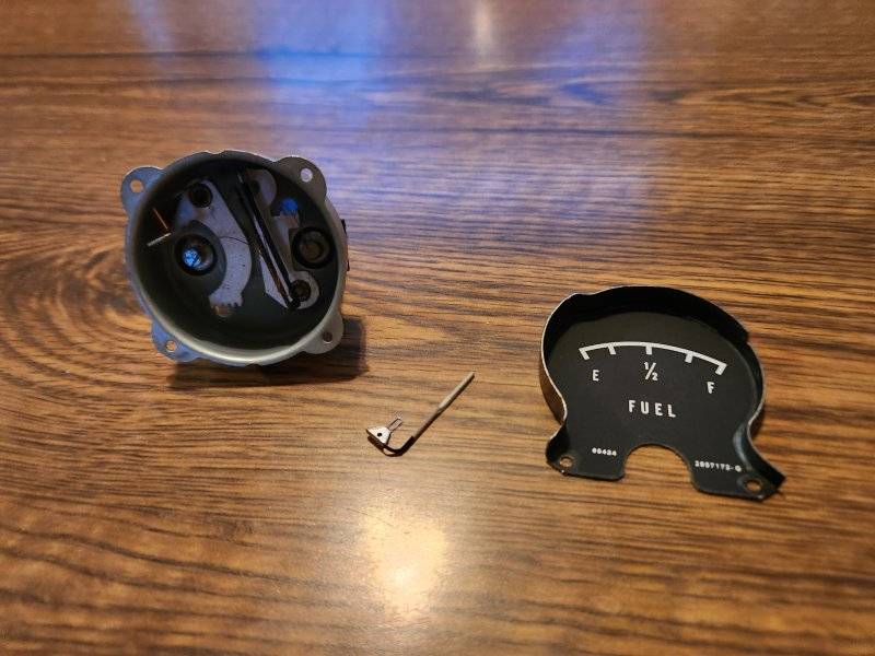

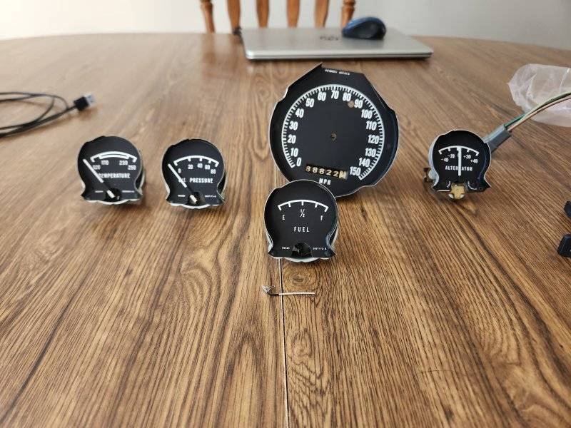

refacing my gauges and yep the fuel needle came off. Any videos out there to reinstall them? Anyone on the boards able to do it? Or should I just buy a new one. thanks Dave
Crap! I don’t know, but my first guess would be super glue and align the needle far left when off???

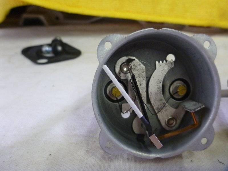

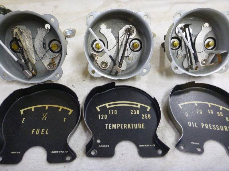

Nothing to lose then Dave. Drill the two rivets out with an 1/8 (#30) drill bit. Look at the mechanism. Straighten out the needle. Pretty sure it just clips on.
Thanks Wayne, Im a bull in a china store. It looks like to hooks and tucks on the bottom. Need to have a couple drinks first. :lol:

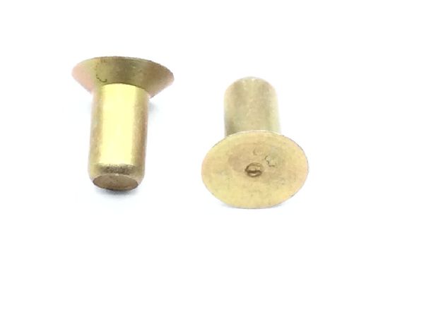

were did you get the rivets and does it take a special gun for them?
Sorry Dave.. I've been on the road since Friday night and just got home. What I used for rivets is shown in my rebuild thread on the Bee. I have millions of rivets in the hangar...
