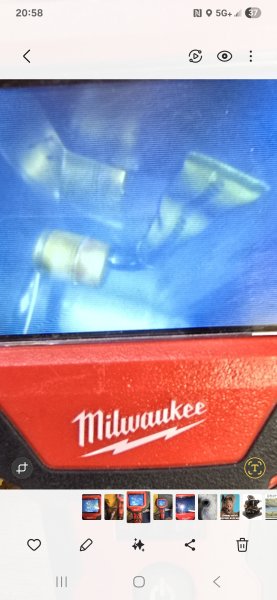

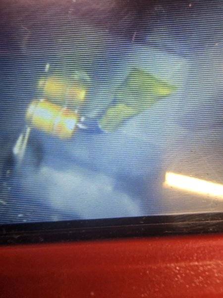

Here's a pic with the sender installed in the tank. The bend in the sock is where it touches the bottom of the tank. This unit has a 1/2 pickup tube. From the pick im guessing about 1/2 to 3/4 between the bottom of the tank and the bottom of the float.

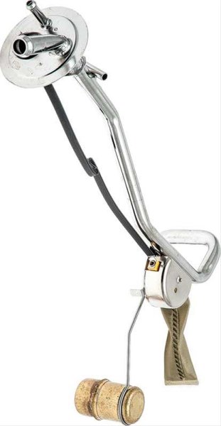

This is a stock image of the one i installed. 1/2 tube 1/4 return. Tweaked in a vice until it touched the bottom of the tank as shown in previous post.
