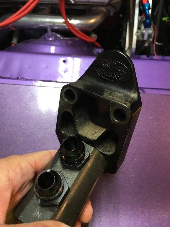

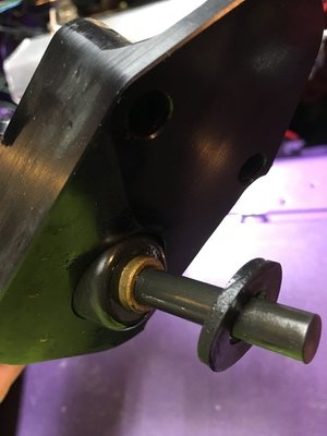

Ok I took the pump off hoping that was the problem but once I pulled it off I can seem to figure out how it could really leak. Other than a small gasket around the push rod in the pump.
all I can think of is because it's such a high power pump it might spray gas through the rubber seal?? I really am lost... only other thing we can think of is it's gotta be leaking through the intake into the heads??
If you can manually pump it by hand, maybe cap the "out", attach the supply, and see if it spits out the backside?
I would still bet on the pump. I don't see how a lot of gas could make it from the carb into the oil pan. I suggest keep testing, as suggested, or maybe buy a cheap pump to install and try. If it still fills with gas then you are right about the source not being the pump.
I once had a pump go and fill the oil pan with a lot of gas.
I did play with the pump and could not come up with any positive leaks. Of course thats not to say my couple cycles are putting the same wear/pressure as 1000 cycles rapidly when its running... I decided to tear my carb apart to see if its to blame. I am thinking it could be the floats because they do run empty but so were the fuel lines... I am going to see if I can get a hold of a electric pump to try and rule it out.
Check cracks or porous casting and leaking float. Guy I knew had a small crack , it drove him nuts.
an easy way to see if its the pump is to put everything back together with fresh oil and run it. pump will fill it up while it is running, carb will leak down over time while sitting. other then really bad rings not many ways to get a lot of fuel in the oil.
