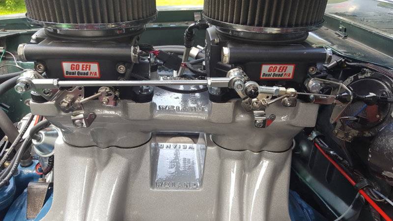

No hesitation whatsoever on a tunnel ram.
Had a fuel pressure issue that drove me crazy, turned out to be the wrong type of hose on the in tank pump.
Teflon fuel lines are easy peasy to put the fittings on and install.
Still need to bend the pedal rod a little to get full throttle.
