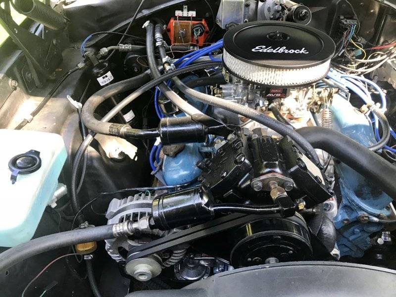

My 360 is behaving better but still having the hard start when hot after 5 min shutdown issue. See my pics. I have my fuel hose running along the fender (from mech pump) then over to the carb to minimize heat exposure. Also added 1/2” wood spacer between carb and RPM air gap intake. So should I go to a 1” wood spacer? If I replace the loose fuel hose and add a factory steel fuel line, won’t it heat the line/fuel easier?

Wonder if those long fuel lines are making it worse? Exposing fuel to engine heat longer?

My thought too. Plus I have 5/16 hard line from the tank to pump then 3/8 from outlet of pump to filter and 3/8 to carb. Seems like a lot of extra fuel hanging around in the 3/8 section. I’m gonna go 5/16 steel from pump to Edelbrock carb 90* hardline unit and fuel filter. Should be 1/2 the length I have now and much less 3/8 section. May have to insulate the hard lines though. We’ll see.

I “had” vapor lock problems a few months ago because my fuel hoses were laying on the manifold:). Moved them to the fender and added wood spacer and now only have the hard start issue occasionally but it’s still just 80 degrees here. I had that rubber gasket on the carb but swapped to wood. I’ll swap it back with steel lines and see. Power tour is 6 weeks away and trying to eliminate any issues!
I was nervous about all the fuel hose flopping around and wanted to go back to factory steel. Essentially I had 2 questions: hard start and was going hard line a good idea.
