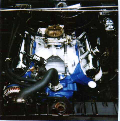

Need Pics of your setup, but here is a shot of my old setup. Pretty straight forward and had no problems except I would NOT recommend the fuel filter in the picture. It's restrictive and I have had two come apart (never good with a gas filter).
The hard fuel lines should be used just on a longer life and safer stand point.
