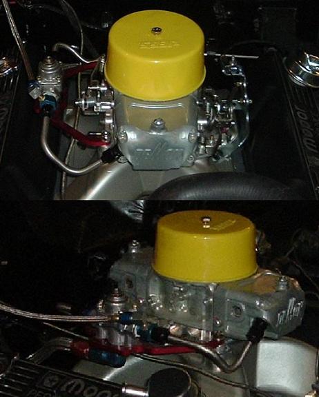

Just some ideas -
The Moroso 65145 is nice solution for a return type regulator but that doesn't address your question about mounting. I know guys that run them. It regulates the pressure after the carburetor. Seems to work fine.
Jegs has a regulator mounting system (Part Number: 555-15081) that I have used before. I used it because I didn't have any fender wells to attach a regulator to and the rules state you can't attach any of the furl system to the firewall. It worked well for me. The flex line and the carb lines stay out of the way when dealing with valves, plugs and headers. The hard lines to the carb solves the problem with bending flex lines close to the carb.
My pictures are not much better but they're all I could find. The issue will be matching the bracket to the regulator you buy or having to buy a regulator to match the kit. Both Jegs and Summit have mounts for different regulators but the key is getting the short fuel line segments to fit if you just buy the bracket alone. The pre-bent steel lines in the Jegs kit fit take care of that and make a better looking installation. Your project is going to have a lot of fabrication involved anyway.

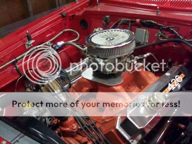

You could do like I do. I run the stock gas tank with the Holley black electric pump. I run braided flex fuel line from my tank to the pump and then I run aluminum line to the front as I put it in the stock location until it gets to the front and then I ran it up inside the pass wheelwell and bring it in the eng compartment through a hole I made in the pass side wheelwell as this keeps alot of eng heat away from the fuel line. Then I flared the end of the aluminum line and slid the braided flex fuel line over the aluminum line and clamped it. And then as you see here I use the braided line to the fuel pressure regulator and carb. I did not want to put the aluminum line up to the regulator as aluminum line can crack when you flare and bolt it to a flare so thats why my aluminum line is not bolted to any hard flares as I flared both ends and slid the braided flex fuel line over the ends and clamped them. Ron

You can see the AN fittings at the carb and fuel press regulator better in this pic. But this was taken before I changed the fuel line and ran it up in the pass wheelwell to keep eng heat away from it. Ron

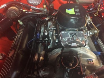

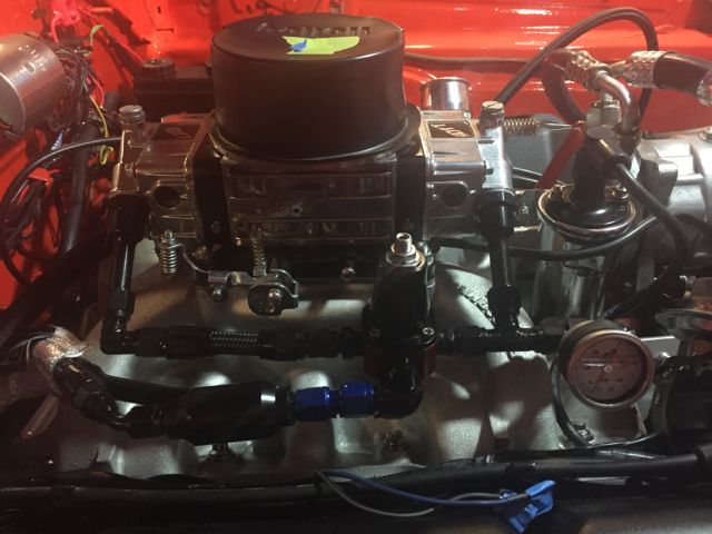

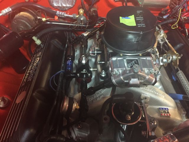

Here's where I ended up. I did use aluminum line for a ways - to the frame rail just at the base of the firewall, then flex up to/from the regulator.
That looks real good. Nice and clean and out of the way. I noticed you have a liquid filled pressure gauge. They can be temperamental. Especially in the engine compartment with the heat.
Never even thought of that! I DID have a different problem with it this morning. I unhooked to fuel feed line to tighten the fitting at the regulator, and by doing that introduced a little air into the system. With the engine shut off (floats bowls full and float valves closed) and the fuel pump running, the little bit of air that got to the gauge caused it to "tap" and bounce. Then I noticed it had a bleeder on top. That must be what it's for - solved the problem instantly!
