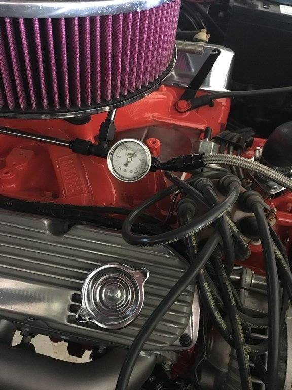

Got something that i may just be paranoid about. Just got my 440 powered 66' Coronet put together into running/driving condition a couple week ago with very few issues so far (knock on wood). After a minor carb (4160 holley) float adjustment the other day, I noticed that my fuel pressure is holding LONG after i kill the engine (9 lbs), and is running higher pressure than normal at idle (10+). It will eventually return to 0 lbs after sitting over night; I assume it's slowly trickling by a check valve in the mechanical fuel pump. My gauge was reading 4-6 lbs until recently. Is this any reason for concern? Thanks in advance.

The fact that it's holding pressure hours after the engine is off is also goofy behavior, correct? At first I thought the gauge was stuck; so I loosened a fuel fitting... fuel sprayed everywhere and the gauge dropped to 0. Hmmmm??

Thanks for all the words of wisdom. I will toss in a different gauge to confirm issue. I'm running a Carter "street super" #6903 mech. pump which is supposed to supply btwn 6 and 7.5 psi. It is new (along with just about everything else under the hood, including the $30+ Earls fuel gauge).
Changed gauges, resulting in the same behavior. Got a new pump on its way... guess we'll give that a shot.
