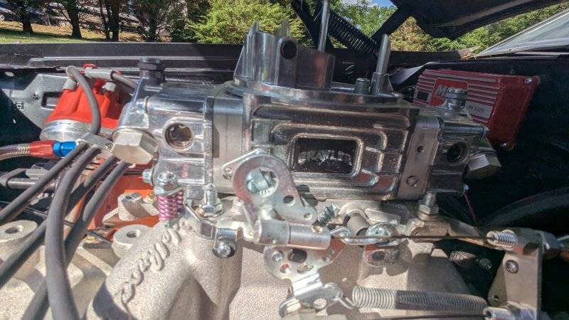

Basic info. to start....
Fuel pressure is 6 lbs
Engine 440, new with about 100 miles
The carb is a new Brawler
The float bowl levels are good...until this issue happens and then the primary bowl is low (bottom of the window)
Once the engine is warm and after driving it for 10+ minutes, the idle goes up and starts to run poorly.
I opened the hood and removed the air cleaner and was checking the carb and saw droplets of gas flying up out of the primary vent tube and into the barrels. It wasn't flooding as if the bowl was over filled or the valve was sticking. The gas was actually drop by drop coming out of the tube and going up about 2-3 inches and then gets sucked in the carb. Kinda weird.
I tapped the check valve thinking it might be stuck, but no change.
I got a brawler for a different car and it ran great out of the box. Even have an AFR gauge for tuning it. It went so well I figured I'd try one on this motor and I think something is up with this one.

You might try installing a phenolic heat separation spacer between the carb and manifold to negate fuel percolation.

It is flooding. Check needle & seats for trash/leakage & make sure you have a filter in the line.
You think I have a fuel boil issue? I didn't really consider... only because the engine temp is about 185-190, but you think that can still be an issue?

Do the vents have baffles installed in the fuel bowls? About the only way fuel can normally get up and out of the vents is flooding, except maybe some phenomenon where fuel agitation from engine vibration is bouncing fuel droplets out the bowl vent and into the vertical risers.

That's a great question. As soon as the workday is done, I'm going to pull the carb and start checking. That'll be the first thing I look for. At the moment, I've done very little to the carb out of the box (still breaking in the engine)... so it'll be good to pull it apart and check.

Today’s gas will begin to boil at around 100 degrees so yes I would pretty much bet on it.
Just in case anyone is interested, here is what I found when I pulled apart the brand-new Brawler carb I purchased from Summit.
Both of the float bowl gaskets we're split length wise across the top and the vent extension in the primary was cracked. The gaskets for the block we're also not in great shape, one has a rip in it that could only be done before it was installed. Apparently, whoever assembled the carb completely jacked it up. I believe this explains the fuel spitting out the vent tube at high idle.
Second finding was that the shaft-mounted return spring for the secondaries was not installed correctly, in that there was no spring pressure on the shaft - it was loose. When I operated the carb the secondaries would stay open about 15-20% (the primaries only "pull" it back so much, and where they stopped the secondaries stopped). Apparently, this was also heat sensitive because the secondaries stuck open after I pulled the carb, but seemed to not stick as badly after sitting on the bench. Kinda makes sense when you think about it. I wrapped the spring on the shaft correctly (matching the other Brawler I have that works), which seemed to correct the high idle issue.
Overall, this is only my second brawler. The first one runs great and came tuned very well (sitting on top of a 400 in my 67' Coronet 440). However, now I'm concerned about that one because it's not perfect and the little things I ignored before could be indications of similar assembly issues.
Anyway, I have a few more things I'm going to look at and test.
