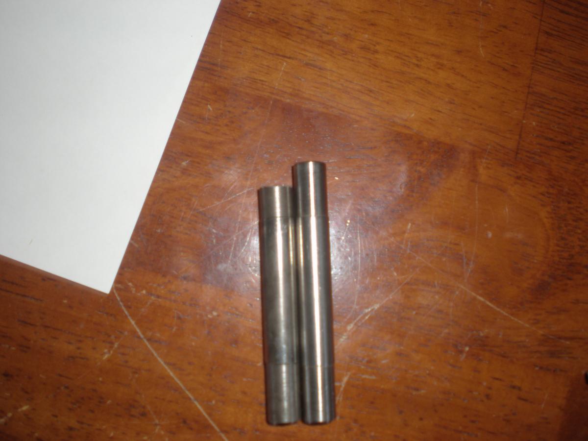

call hughes engines and get the hardens fuel push rod , the happend to me and the mopar rods are not hardened and wear badly . Also this ate my main bearing also my front main only had 3500 miles on it and was warn into the brass because of this fuel push rod issue . hughes also has a big magnet oil pan drain plug get it also .
this was a new mopar performance rod and only had 3500 miles on it
