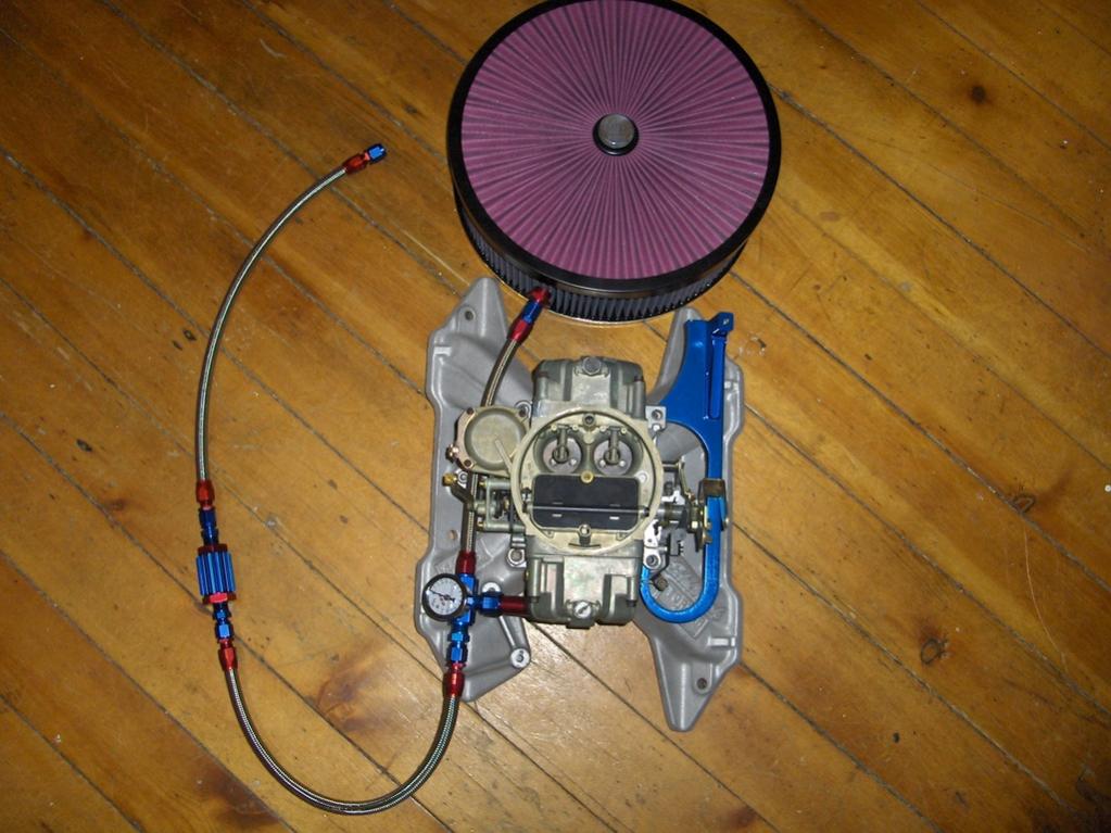

I've got a Holley red pump, 1/2 Aluminum line from sender to regulator then a (-6) line in to a Russell fuel rail with in line filter.(see pic)
I'm now changing this set up to a dual (-6) into the carb with dual inline filters.
