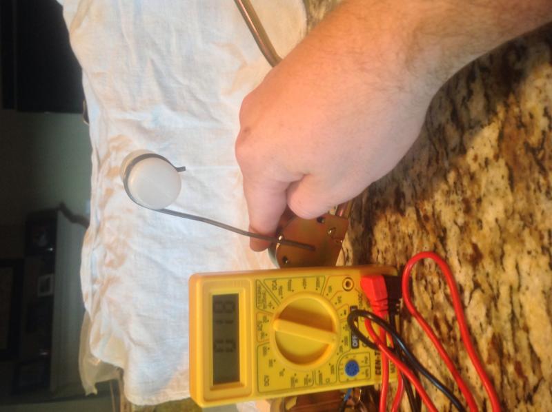

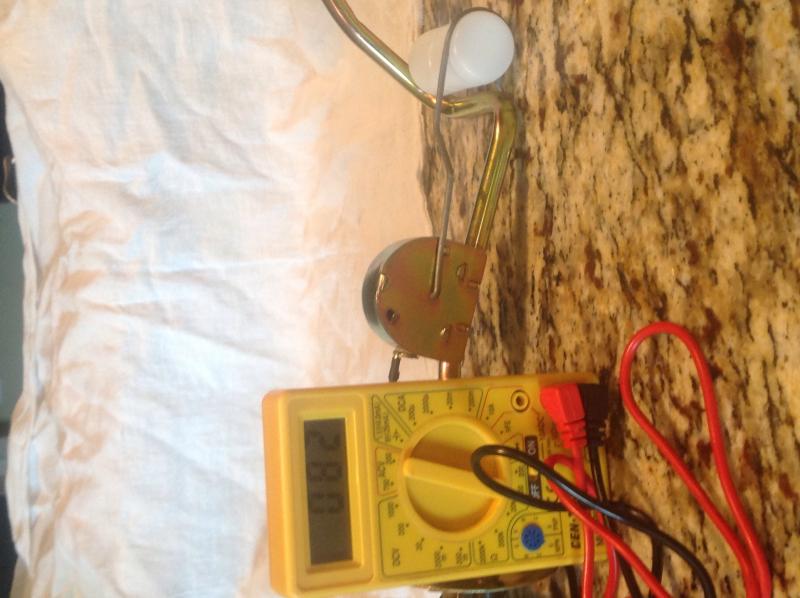

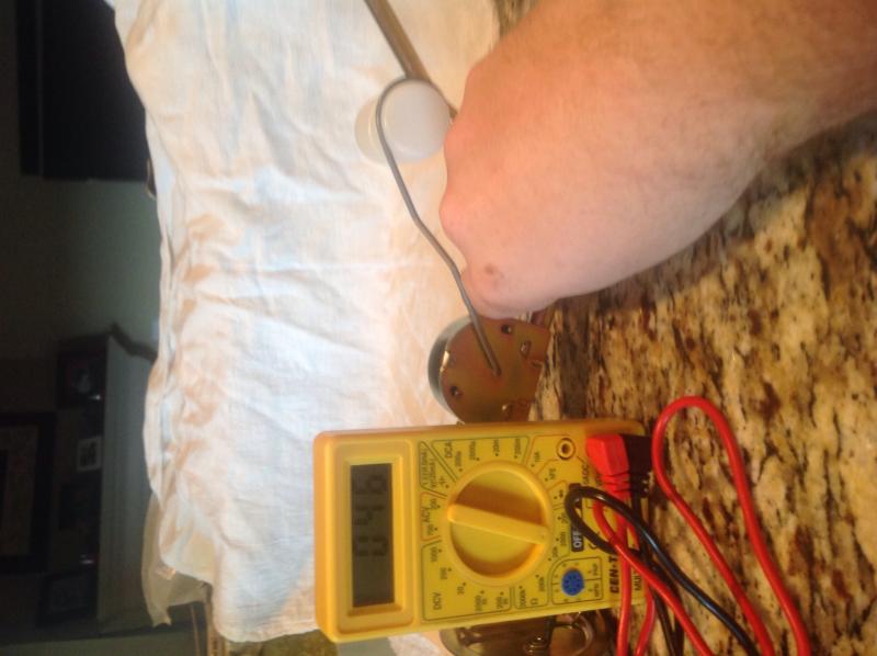

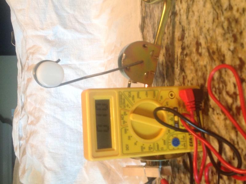

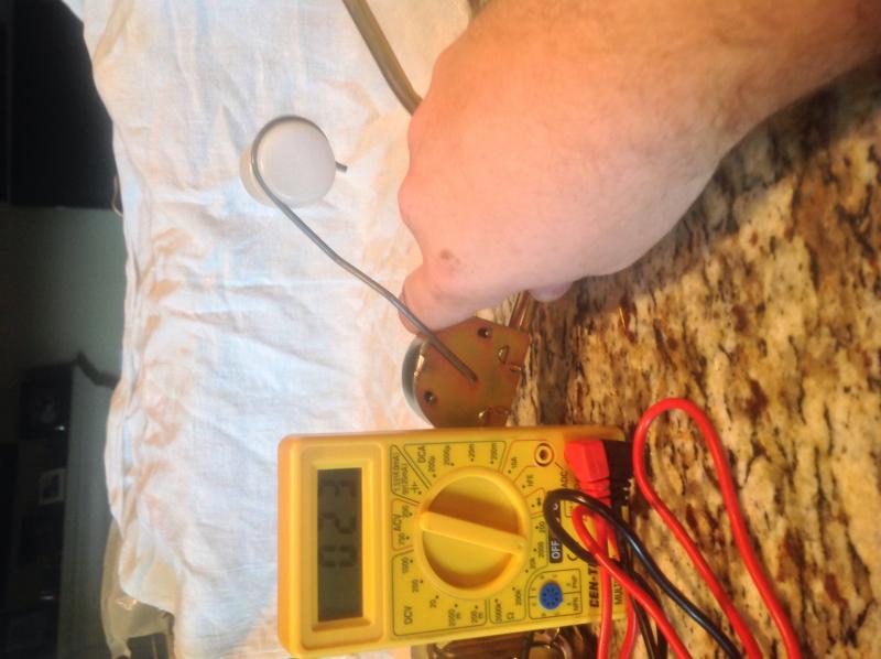

I don't know what to take pics of except maybe the gauge at full and empty.
I wouldn't mind seeing pics. with an ohm meter hooked up when the arm is at 1/4, 1/2, and 3/4. Empty should be around 73 ohms, and full around 10 ohms. The problem with the new senders is that they are linear whereas the originals were not.
Pics
