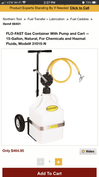

So was wondering what type of fuel transfer systems do you guys use. I was looking at this but don’t wanna to spend $400. I have a 5 gallon container would like to have a better way to transfer fuel from container to car and from car to container.
Ideas and pictures please!

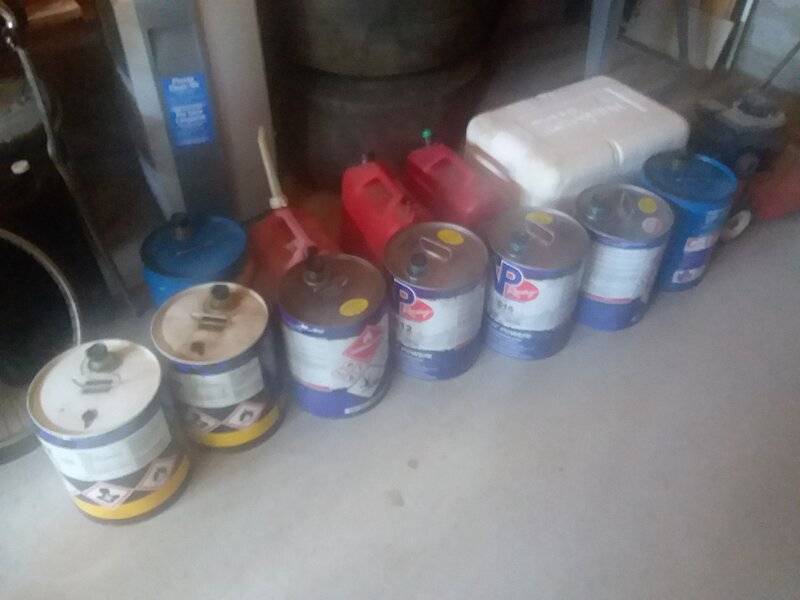

I use freebie five gallon race gas cans that i salvage out of the trash at the racetrack, when the ricers throw them away. And i use a 99 cent store funnel to pour the diesel out of the cans into my pickup. With a t shirt as a filter.
I also use the can when i go get my $4 race gas...... at the airport.
I also use an adjustable stand that I built to hold my mufflers up while I built an exhaust system on a lift. Works great to hold up the gas cans while pouring. Sorry, no pics of it .
Thanks great looking cans! I do however need a pump to move fuel around from one tank to another or to empty old fuel out of a tank etc.

I can’t find a simple hand crank other than the one above which they want way too much. That set up would be good enough for me. Many hand crank pumps aren’t designed for gasoline but for diesel or other higher viscous liquids.
