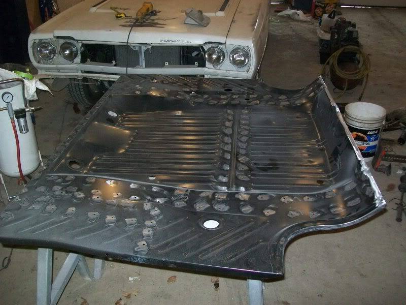

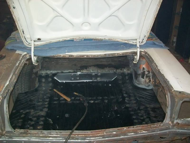

Just went through replacing a 70 RR trunk pan,lots and lots of work and am halfway on the floor pans.There has to be at least 150 spot welds in the trunk pan alone.
155 holes in my 69 B-body trunk pan.
And that was with cutting the front 8" off the one piece trunk floor replacement panel.
Between my 68 Coronet, a 71 Roadrunner trunk and the trunk I did on my 69', I spent at least 12 hours from start to finish on each.....At an average shop rate of $75 bucks an hour, your looking at $900 bucks in labor and then the pan cost on top of that. That is with no cost yet for finish work (seam sealer/sanding/priming/painting...$500-600?) Floors would run about the same.
