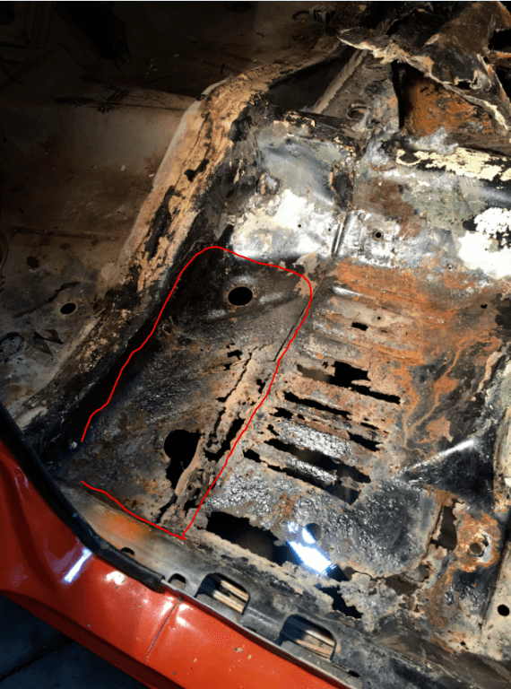

I am in need of some floor pan work. I saw that Jim's has full length 1/2 floor pans that are extended to include "some" of the rear seat foot well. Does anyone know where this extended pan ends?
Said another way, will the longer panel replace this rot (circled).

By comparing the photos from the website with my own floor, I think I have figured it out. Thanks.
i'm not familiar with the pan Jim's sells
looking at what you got
i would just get the full pans
it is probably less work to do the whole thing
then to splice in patches.

Found that under 2 layers of previous repairs. Once with riveted and tarred flat sheet metal and then later with poured in fiberglass.
