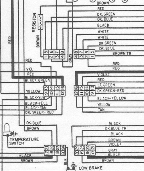

Can someone just go over the underdash buss terminal #3,#4, and #20 doesnt have a color on the diagram
