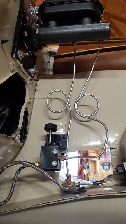

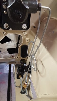

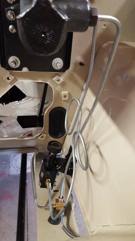

I could feel the difference and felt a bit at ease when I used one back when I raced my trusty Roadrunner. Here is my layout on the Bell. This layout only would work with an automatic, since I located the valve right in front of the clutch rod hole. Oh well! I get enough 4 speed with the other car! The Ladies can drive this one!!
