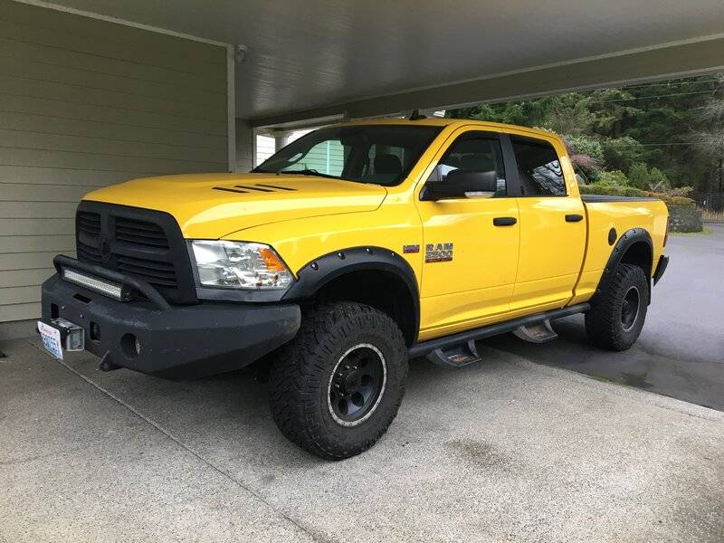

I don't want a dash cam, I want a front cam so I can see what is directly in front of m. I have after market bumpers and I am always afraid of hitting someone or something in a parking lot.
