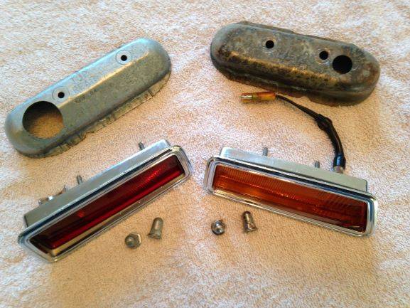

I never did my light buckets yet but I did do my license light bracket and rear clearance light housings in the trunk and turned out super. I did clean my front marker light housing but the corrosion got the best of them and going to paint them some silver color that will closely match I hope.
