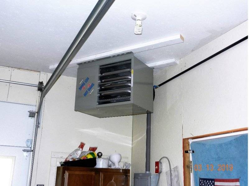

Not an "Expert - but - I have this Natural Gas Heater, in My Garage. -- 30,000 BTUs -- Garage is 28 X 40 ft., and it does a great Job, here in N.E. Pa., where it gets pretty cold, in the winter.
Not an "Expert - but - I have this Natural Gas Heater, in My Garage. -- 30,000 BTUs -- Garage is 28 X 40 ft., and it does a great Job, here in N.E. Pa., where it gets pretty cold, in the winter. View attachment 918977
You may not be an expert, but, it's the right unit and hung in the right place, well done!!
