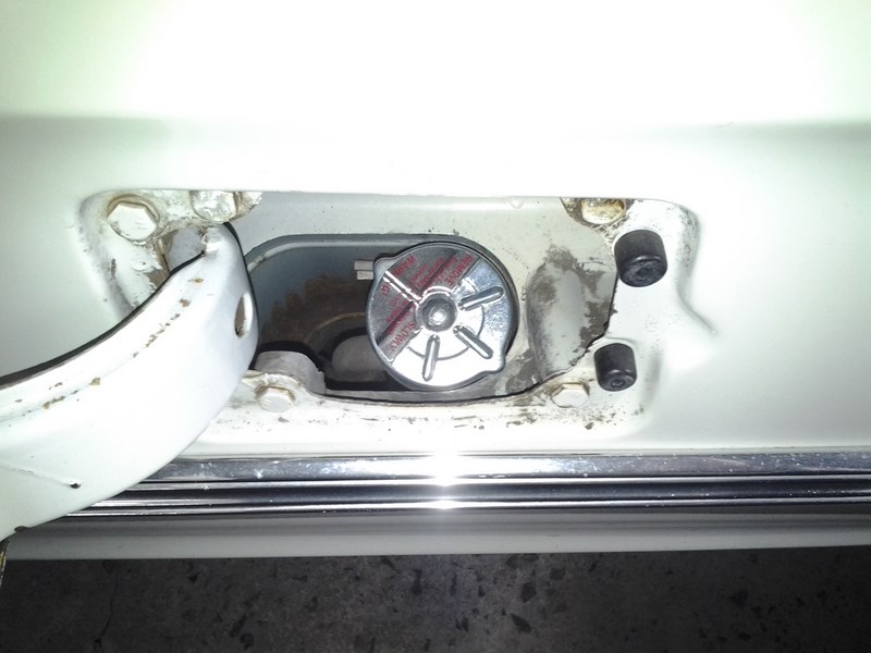

Is there anything missing here? The Gas neck seems to be moving from side to side and hitting the one side making a rattle noise.

There is a bolt that holds it to the housing from the trunk side.
You can see the bracket in your pic.
