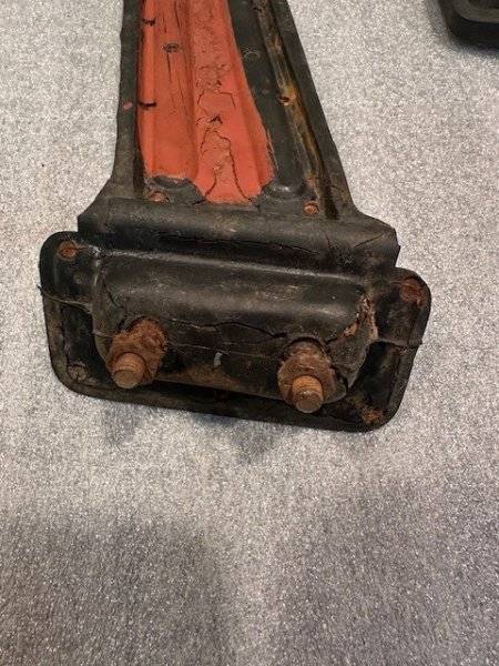

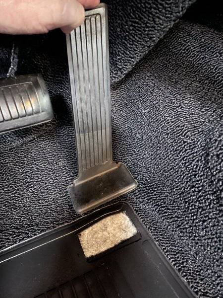

How do these things ever sit flush on the carpet with this huge "bump" on the bottom?
NOT for a 63-65 B body ^^^^^^. You need to cut a matching hole in the carpet and pad.
Thank you guys, I just wanted to confirm I wasn’t missing anything. Looks great by the way!
That big bump makes contact with the floor pan. You have to get your carpet as exactly located as you can. Front and back, side to side and overlapping the rear carpet. Once you're satisfied where it all lines up take a scratch awe and poke the two holes for the studs from the bottom of the car. Now you can measure off the holes to the size of the rectangular "bump" under the pedal. Cut the carpet and any insulation out. Then you can install the pedal. The one stud underneath has a clamp for one of the cables. (I'll have to remember which one).
Don't be surprised if the pedal won't land completely on the heal pad. Some get lucky, some end up like mine.

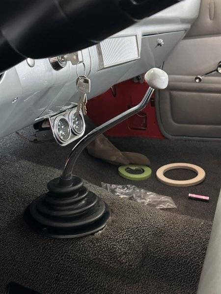

A cool trick is to use a soldering iron to make bolt holes in the carpet like seats, seat belts. It will melt the carpet and you won't have any loose strands.

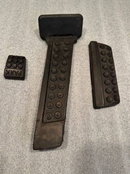

Thank you again guys. Unfortunately/fortunately I'm installing vinyl flooring! Ugh. What a pain in the butt. But I love it. No pun intended.
No heel pad. Wasn't available. But my brain is still working! LOL. But got the factory t-85 shift rod and knob! That helps me over the disappointmnet of no heel pad! LOL. More pics when it comes together this weekend.
Hope your carpet came in better shape than mine did.
Post in thread 'Taking Up New Residence' Taking Up New Residence
Neat method, wish I'd have heard of this before, I had some hassles when running bolts through the carpet for the modified console I installed, the carpet would get snagged while threading the bolt, remove and cut more. Messed up the carpeting, but fortunately most of it is hidden. Just did NOT like the idea of damaging a new carpet either way.
