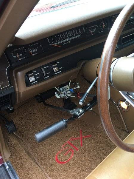

The Monarch hand control system I installed in my GTX addresses the issues you raised. I usually drive with the pedals, but use the hand mechanism on longer trips.

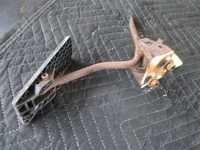

Is that the 71-up pedal?
71 up[?] pedal assembly like that will work. A,B, and C body pedal assemblies are almost identical as shown, and should be super easy to find.
i also believe the throttle cable attachment is the same as the floor mount pedal, so no mods needed to attach your original cable to the suspended pedal.
