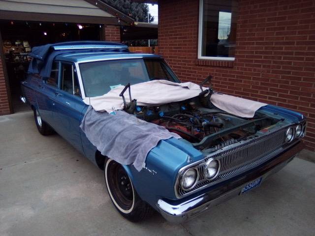

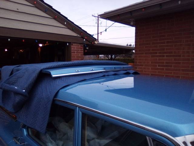

Son was over for the holidays...helped me get the hood off the ‘65, a 2-man job. The luggage rack on a wagon is about the nicest storage spot for a hood you could ask for.

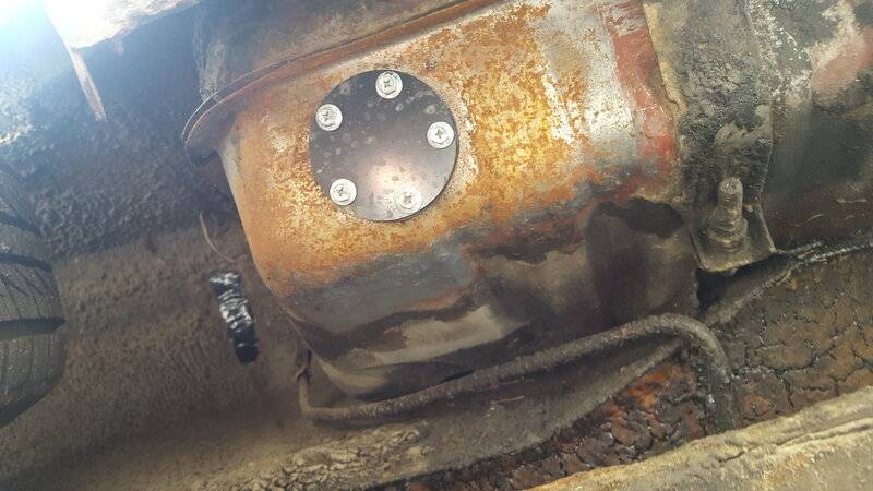

My wagon sat for decades with an empty tank, must have had moisture in it, bottom section had pinholes.
All are Tanksinc sending unit eliminating parts off of Summit.
Threaded C ring, bolts with o-rings, metal cap, gasket, not the cork gasket, the other one, neoprene iirc.
Left tank in car. Cut a hole where all the pinholes were big enough to slide the C ring in, drilled 5 holes for the bolts, done.
I had to bend one end of the metal plate slightly as it was close to the edge of the tank.
