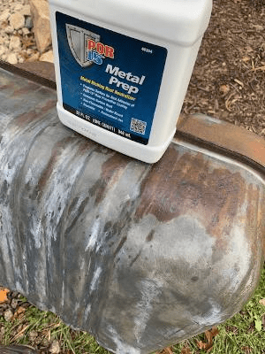

Ok, so I'm trying the POR-15 tank sealer. I already wire wheeled the tank. I used the Metal Prep. Dipped a rag in it and kept rubbing it on every few minutes for about 20 minutes, then washed it off and let the tank dry.

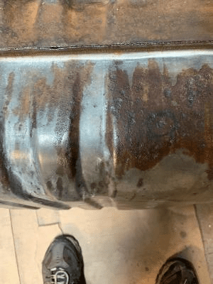

The tank with the holes marked. the sharpie find of worn off.

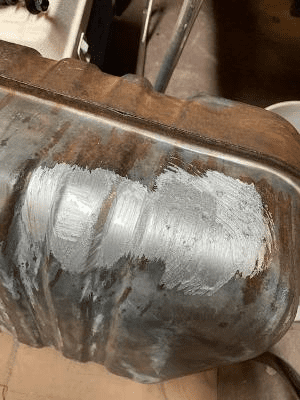

It says to brush it on over the pinholes.

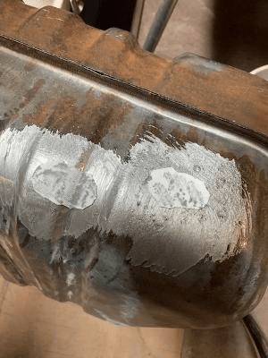

Then cut out a cloth patch and put it over the hole. Two patches for two holes.
Then brush the sealer over the patches and let dry. We'll see how it works.
