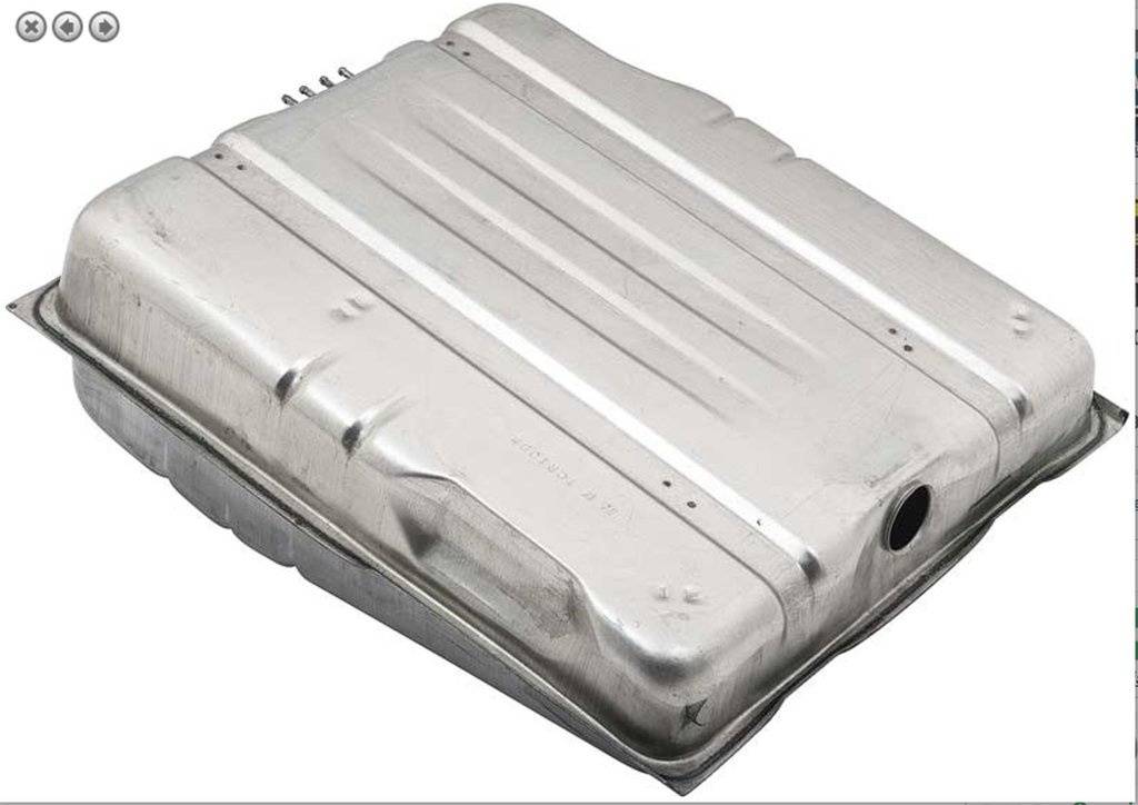

They run the entire length. If you look at this picture, on the rear lip of the tank are two sections that are bent up. Those are where the straps come up from the underside of the tank. The channels run down the length of the tank's underside just like the ones on top.
